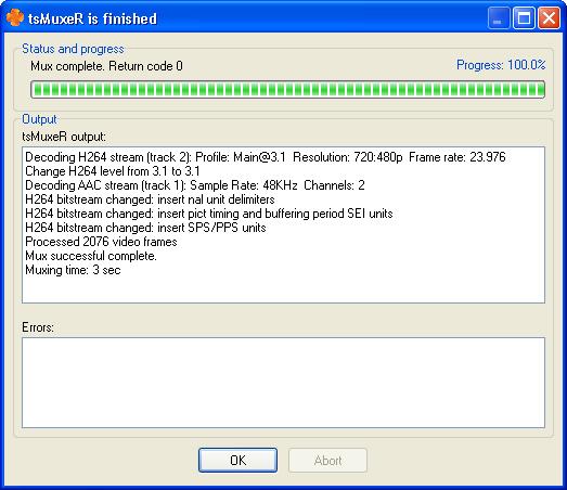

  4. Ok. I managed to get a new .ts created. I had to use another tool to split (demux) the .mp4 apart. That tool was mp4muxer..found laying around on my xp 's HDD. Anyway.
    dgavcindex still will not open the newly created .ts video. It just crashes with the usual windows error message--you know.., the one that says, [send error report] or [don't send] blab blab blab..
    Here's my successful creation of the .ts file.
    if anybody is still up and reading/curious..
    Thanks for taking the time to look,
    EDIT: ok. in addition to the [M2TS muxing], I also did a [TS muxing], and still no agreable w/ dgavc.
    file plays fine in vlc however.

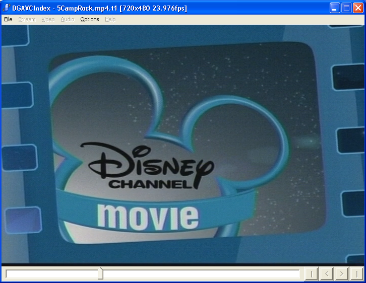

    Evening everyone. I'm sorry. I finally sorted it all out. It turns out that the version I had was the problem with all the other failed attempts (because I think it was borked) and also I had the ver num incorrect--it was actually Alpha 35--that was the one borked on my xp home system. And when I bumped back to an earlier version, (I found Alpha 18 on my hdd) it worked perfectly!! Yippe. Still.. can't believe how close I was, after so many months of unresolved. Anyway.
    I do realize dgavc does not work with .mp4 formats. They have to be demuxed into a .ts (some tools write / append an t1) and dgavc will open those. Course, after re-muxing back to .mp4, dgavc will no longer read them. Its the case of the double-edge sword I tell ya
    But, I'm happy it all worked out, and I can now finally analize my x264 cli encoded videos, yeah, me!
    NOTE:
    I managed to find v1.0.7 and (almost) no problems. Although the files open, some of them do not allow you to pan them inside the timeline. And the only way to review them is to press the F5/F6 keys else the "<" and ">" keys won't work. So, I'm bumping back down to the more reliable Alpha 18 for the time being--I can live without the "[" and "]" cutting.
    Thank you all, for all your suggestions. And not to forget, my thanks goes to the developer of dgavc and the work he put into it..I'm happy
