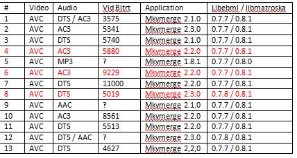

It's actually a FireWire 800 drive, and, in trying the programs you suggested, I came across an interesting find. Apparently the files work perfectly in Windows-- sort of. I've always used OS X for playing movies (I dual-boot Vista on a MacBook Pro, Early 2008 model), and using VLC in Windows yields, well, results. However, I'm quite disappointed with the 1080p downscaling VLC does in Windows to match my computer's resolution. The Mac VLC Player looks much much cleaner, as does MPCHC in Windows. Nevertheless, I would like to avoid a reboot whenever I want to watch these movies. I attached a table of the MediaInfo information I thought was necessary, though I really don't know what I'm looking for. Is there something I could do to fix this in Mac? Perhaps, maybe, re-encoding the files?
Also, in the table, the red lines (#4, 6, 8) are the files that are giving me problems. Thanks much!

Nothing shows that's odd to me. They seem to be a mixture of filetypes, same as the others.

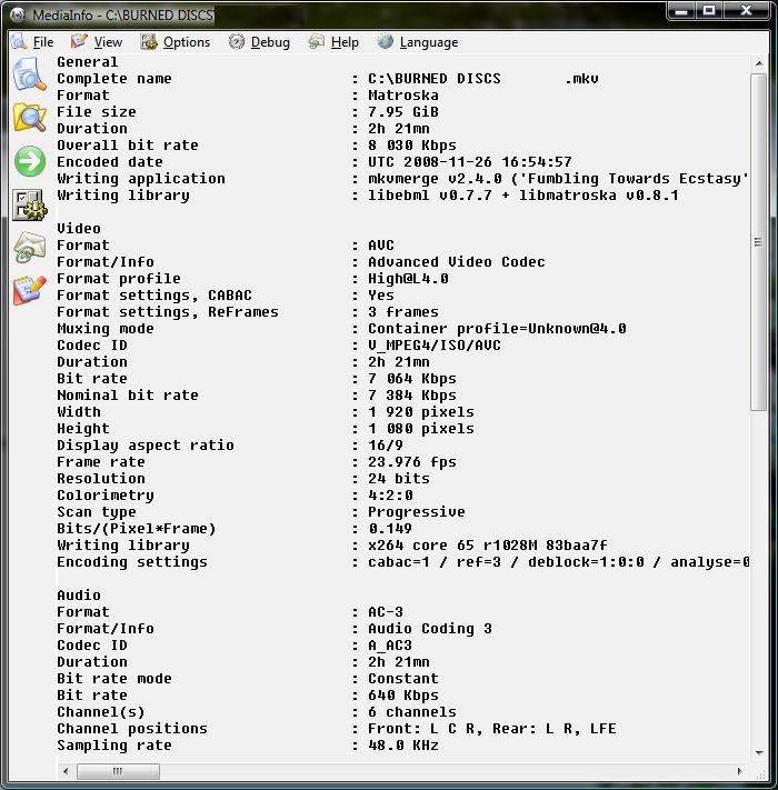

This is a MediaInfo screen shot of one of my DVD>MKV HD conversions. I cut off some additional info to the right to keep the size down. This type of information is probably what you would have to use to compare your good files to the problem ones.
