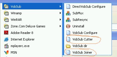

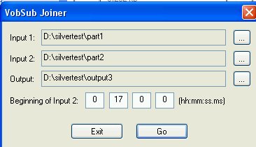

  3. Thanks for the info. I was able to do it with Vobsub Cutter and Vobsub Joiner. I wanted to cut out about 3 minutes of a movie with idx/sub subtitles (from 17min 0 sec to 19min56 sec.) I used an avi editor/joiner (like Boilsoft or VirtualdubMod) to save the first part (from the beginning of the movie to 17 min) and the second part (from 19min 56 sec to the end of the movie). Then I combined the parts together. Then I used Vobsub Cutter (see screenshot 1) and inputed the idx file and set the end as 17 min and saved as part1. Then I used Vobsub Cutter again (see screenshot 2) and inputed the same idx file and set the beginning as 19min 56 sec. The end of the movie was automatically entered. I saved this as part2. Then I used VobSub Joiner (see screenshot 3) and inputed part1 and part2 and set the output folder as output3 and clicked go. Also it is important to enter the time (in this case 17min) of the beginning of part2. Screenshot 4 shows the software I used to cut and join idx/sub files.
