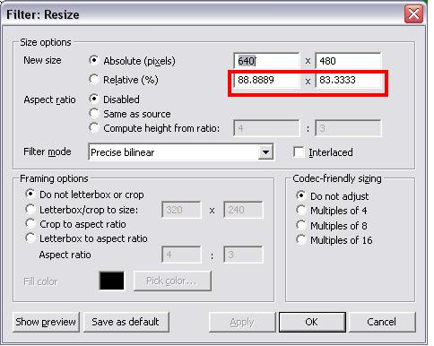

    VirtualDub's resize filter has several methods to choose from:

    I did exactly the same, but after I changed the numbers above to 640x480, the numbers below (which I marked here in red), were changed automatically to different numbers than the numbers in your picture.. why does it happen?

    I was using a different resolution source file when I made that image. Don't worry about the Relative % numbers.
  17. The relative % numbers changed because the relative % of the new resolution was changed from the original, by you. The numbers show the resolution change as a percentage from the original. 640 is 88% of the original res.

    so I just need to change the resolution every time to 640x480, without regarding the Relative numbers?
    The video you were working with had a 4:3 display aspect ratio. Hence the 4:3 frame size (640x480). If a video has a different aspect ratio you would use a different size. 16:9 should use a ~16:9 frame size like 720x400, 704x400, 640x368, 640x360, etc.
