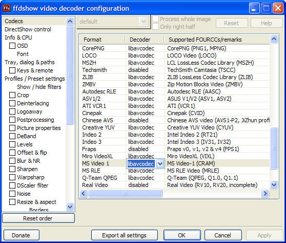

  5. Install ffdshow, enable MS Video-1 in the configuration from "disabled" to "libavcodec"
    I'm not sure if Pinnacle is vfw based or directshow based, so I would do it in both the vfw configuration (gold colored icon), and the normal configuration (red colored icon)
