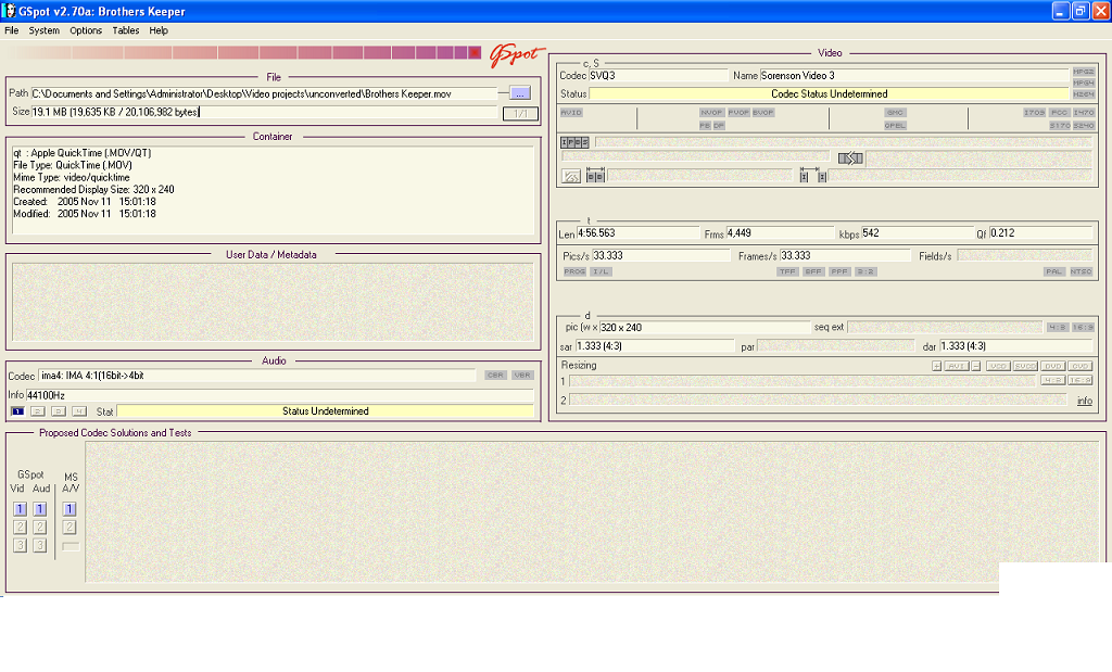

They are all different and say "unsupported" in my ps3.Some SAY they are AVI but they wont play on the game system only on pc.I'll post a screen cap of a file that is MOV but i only have 3 of them that need converted and fixed to play on the ps3 the others are AVI

If these are standard 700/1400 MB avi files then the best you can hope for is to repackage them to play on the PS3. If you have to re-encode the best you can hope for it to keep the quality you have without making it worse. If the files are already showing macro-blocks then they have already been compressed too much and the damage is done. You could try a deblocker, but this will soften the image as well, and then you will have to re-encode.

There i did the picture i hope it works.

something that really doesnt make sense on the ps3 when i goto the video files that says "unsupported data" i click information to see what it says and it says the exact same thing as a file that is supported give or take a few kbps on each file and resolution a little different but the video codecs seem the same and audio codec too,it just doesnt' make sense =(
gspot%20cap.bmp -

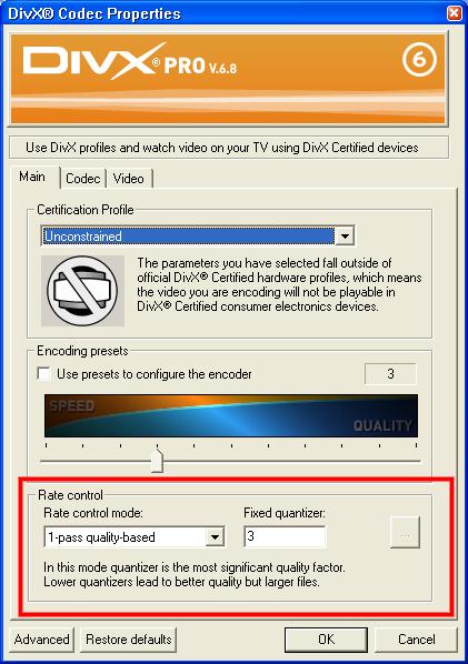

Forget bitrate. Use constant quality encoding. Select the quality you want and the encoder will use whatever bitrate is necessary to deliver that quality at each frame. In Divx it's called "1-pass quality-based". Try a quantizer of 3 for good compromise of quality and file size. Use 2 if you want higher quality (relative to the source, a bad source won't get better), 4 for lower quality. The files may grow a bit larger or smaller but the quality will always be what you specify.

There are two different approaches to encoding video: In one you select the file size (usually indirectly by specifying a bitrate) but you don't know what the quality will be. In the other approach you specify the quality but you don't know how big the file will turn out. I'm suggesting you use the second method.
If the software you are using gives you access to Divx's configuration dialogs select "1-pass quality-based" encoding and set the quantizer to 3:
In Xvid you set the Encoding Type to Single Pass, and the method to Target Quantizer, and set the quantizer value to 3:
If the software doesn't give you access to these dialogs look to see if it has similar settings somewhere. This is a single pass method, often called Target Quantizer, Constant Quantizer, Constant Quality, Quantizer Based, or some such. -

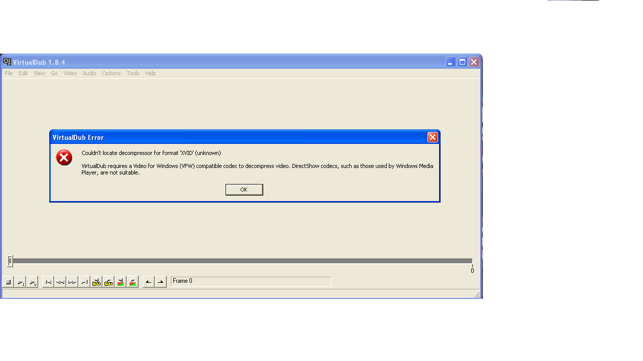

I downloaded vdub and now when i try to put the files in it i get this error.
vduderror.bmp -

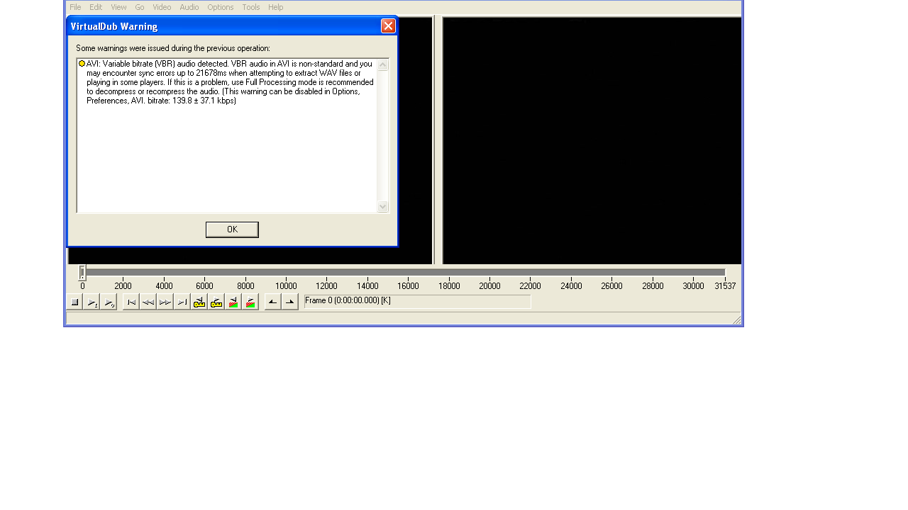

Ok,I did that and that seemed to work thanks but now this new warning comes up should i do what its telling me to?

vdubwarning.bmp -
You can usually ignore that error. VBR audio used to be a problem but it was fixed in 1.8.x.
