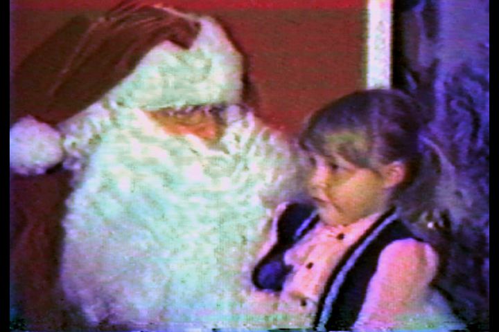

    Hi guys. I have some videos given to me on vhs. They are old commercials that were made by a co-worker for tv some years ago and have extremely deteriorated. I have fixed them up a bit but nothing that I am proud to give to her. I know there maybe only so much that can be done, but just wondering if there could be anything else I can do with the equipment i have, or if i purchased other equipment woudl that help.
    Here is a sample of the video. Notice Santa is all yellow and the video is grainy and the red behind him has various lines of green in it.
    Sample #2 is the same but i went into final cut pro and changed the white to be Santa's suit so it looks more natural, but still more to be done with it.
    Any suggestions?
    Would video enhancers and the like help at all?

    What format or codec are they in? VirtualDub has quite a few filters available, some specifically for VHS. One color adjustment one I like is ColorMill: colormill2.1.1.zip You can probably do as much in software as most hardware devices can, and much cheaper.
    VD outputs in AVI type formats. You can also use AVISynth as it's much faster, though a bit of a learning curve. Other VD filters here: http://www.thedeemon.com/VirtualDubFilters/ and here: http://neuron2.net/

    Here's a quick adjustment from your first photo using just ColorMill in VD:
    Some noise reduction might help, but not so easy with a static image. A JPEG is just one frame, but you can see the possibilities.
  7. This is my proposition:
    I have used
    1) color mill (that i had never used untill now)
    2) neat video
    3) msu old color restoration
    4) msu color enhancement
    This is not perfect but that's the best i could do with the little time i spent on it (not so little actually)

    That looks pretty good. A little blown out on the highlights, but the dark parts look good. I guess my point is you can do a lot with software color correction. Still not a great demonstration unless you have a real video clip.
    I like everything about Neat Video except the price, but it does do well with old video. But it is also slow unless you have a very fast CPU.

    You should really fix some of this in the analog domain, with the VCR and other equipment (TBC, proc amps, etc) prior to conversion. If this is a really important tape, I'd suggest paying a service if you don't have the funds to purchase (and cannot borrow/rent) the best equipment.
    Software filters can help, but much of the damage is going to be permanent. The chroma noise and possible tracking errors are really kicking your butt here.
    Ideally software correction is for ONLY AFTER you've done all you can in hardware.
