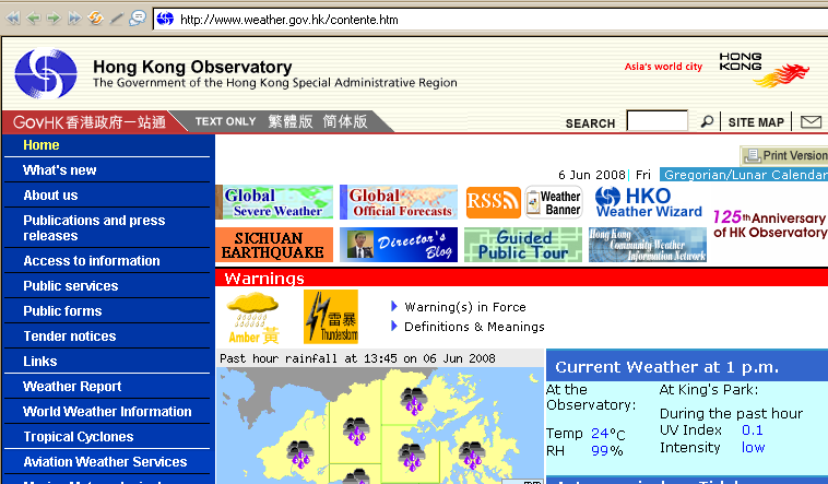

  24. Member AlanHK's Avatar
    Join Date: Apr 2006
    Location: Hong Kong
    I've several times read folks in Hong Kong, Malaysia, Singapore griping about high humidity destroying their media. I don't believe it's being stored properly. The humidity there is 60-70% most of the time, not 97% (even the thickest part of the Amazon is never 95-100%). Those countries are no more special than Florida, and I don't see mass complaints from Miami.
    Do not call me a liar again.
    I live in Hong Kong. You don't.
    You keep pontificating about all kinds of things in Hong Kong, usually, as in this case, in the most insulting and dismissive and ignorant way.
    Just STFU about things you have no clue about.
    • [list:a222d55a79][list:a222d55a79]RH = Relative Humidity = 99% at this moment.
