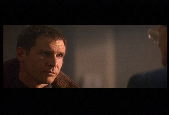

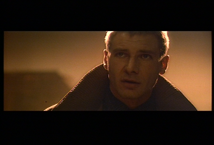

    Here are a few images for whatever they may be worth to you and your endeavor. Nothing was
    done to them other than what was noted in above paragraph.
    ** FRAME: 1152, 704x480 winfast capture via composite connections
    ** FRAME: 3314, 704x480 winfast capture via composite connections
    ** FRAME: 3438, 704x480 winfast capture via composite connections
