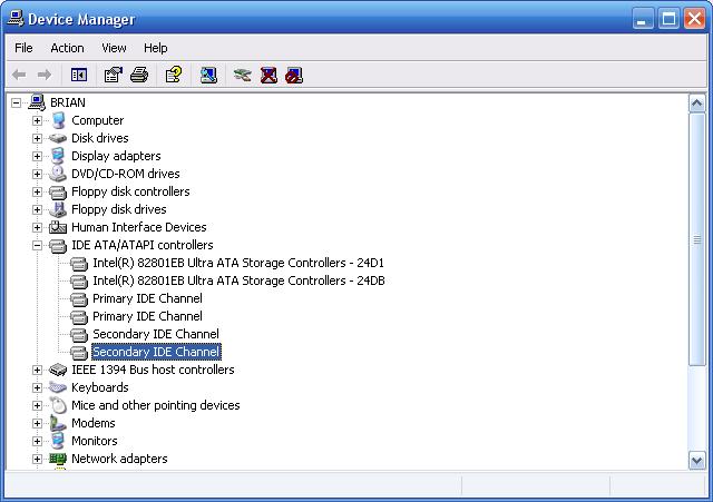

    I had the same problem as HalO5154, so I followed along the thread and checked my DMA status only to see:
    Anyway, my IDE channels seem to be duplicated! I have two primary and two secondary IDE channels. (Plus under Human Interface Devices all of those are duplicated as well, Ive discovered. But not elsewhere.)
    Under the Properties of the first listed Primary and Secondary IDE channels Transfer Mode is listed as DMA IF Available but current Mode is listed as Not Applicable. The second entries for each say DMA If Available/Ultra DMA Mode 5.
    Do I just uninstall these entries and hope that fixes my sudden slowdown? Can anyone think of any reason there would be two Primary/Secondary channels? What about the INTEL Ultra ATA controller entry?

  26. Member [_chef_]'s Avatar
    Join Date: Nov 2002
    Location: Germany
    Its about the crap intel drivers.
    Remove them, then restart.

  27. Member
    Join Date: Jan 2007
    Location: United States
    Ok, they all just reappear after reboot.
    Except, now the second entries say Ultra DMA Mode 2 insteasd of Mode 5.
  28. aBigMeanie aedipuss's Avatar
    Join Date: Oct 2005
    Location: 666th portal
    if mode 5 can't be selected it could be a bad cable. mode 2 is the best a 40 wire cable can do, mode 5 needs 80 wire. a ground wire could be broken.
