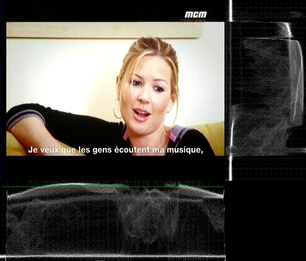

  15. I determined the the ColorYUV() settings using The AviSynth filter called VideoScope(). It shows you an oscilliscope graph of the luma channel along with the video:
    I marked IRE 0 (desired black level) and IRE 100 (desired white level) with green lines in the bottom graph. This sample is before fixing the levels.
    From that I estimated the arguments for ColorYUV() then fine tuned (using VirtualDub to open the script and view the scope). Note that the very first frame is brighter than the rest so I ignored it. I just realized that I used the original frame with the black borders to adjust the levels -- you'll want to fine tune the black level without them.
    Once I had the levels right I added the Neat Video filter to VirtualDub. I used Neat Video's automated tool for setting the filter parameters -- mark a flat area (I used part of the white wall in the background) then have it sample the noise in that area. Other than that I left everything at the default settings.
    I cropped the frame (in the sample video I posted) because the demo version of Neat Video (the only one I have) has a 640x480 frame size limit.
