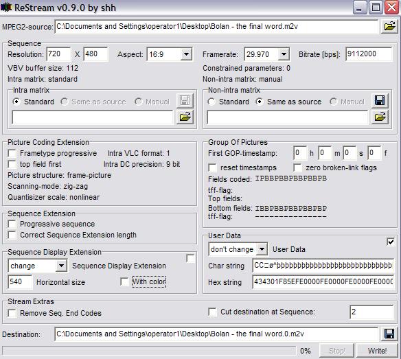

    Take a look at restream - it should be able to change the aspect ratio of the .m2v

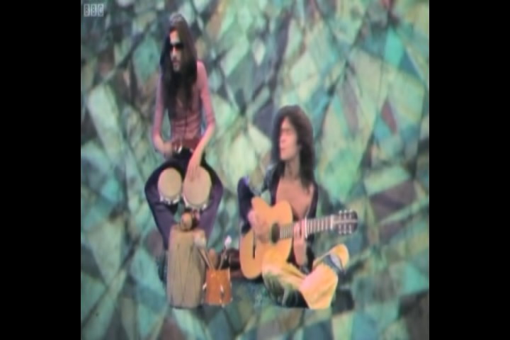

    this is what restream is showing me, but don't know what to change to make 4:3 into 16:9?[/img]
    Join Date: Jan 2008
    Location: United Kingdom
    looks like this: 4:3
    but should look like this: 16:9

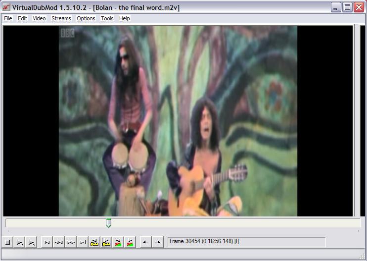

    jagabo:
    .m2v image from virtual dub mod without resizing
    however, it does not appear like this on tv!

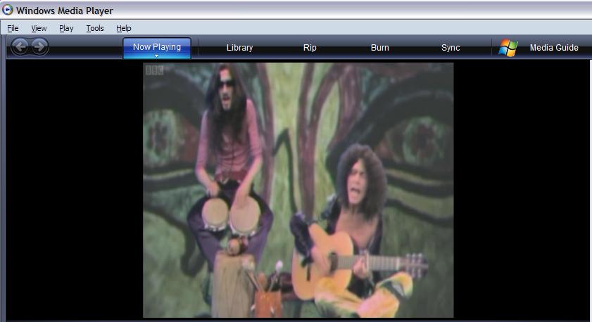

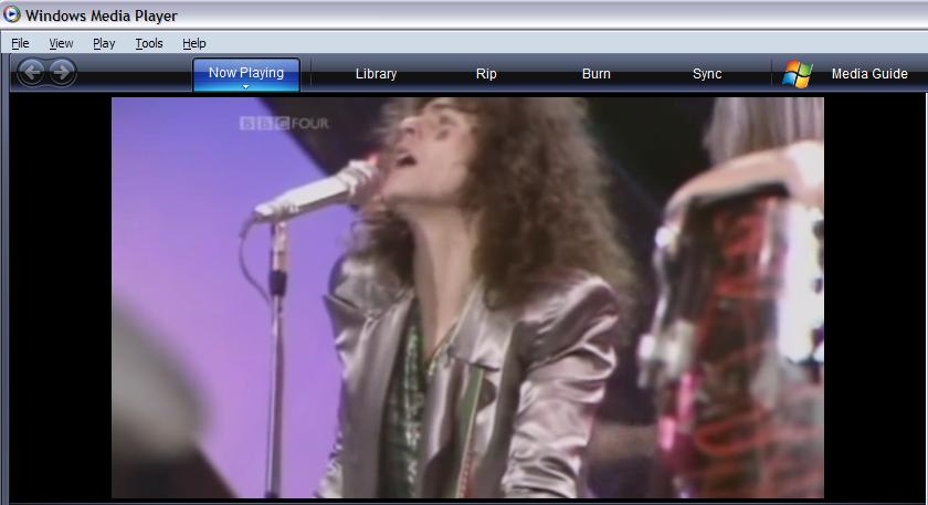

    THE WMP shots were NOT re-sized either!

    According to virtualdub you did an improper encode with black bars on the sides,you will have to re-encode and lose the black bars.

    It's not supposed to. The point of this exercise is to see exactly what the contents of the video frame is (before any resizing, pillarboxing, or letterboxing by the player to correct for DAR/PAR). VirtualDubMod's default behaviour is to show the video frame pixel-for-pixel in the display window. So a 720x480 frame will appear as a 720x480 image regardless of the DAR/PAR. That's what we need to see to determine how much of the frame is the actual picture and how much of the frame is letterboxing or pillarboxing added by the encoder.
    By the way, you can save the frame as an image using VirtualDubMod's Video -> Snapshot source frame. If you want to use a screen cap utility to post the whole VirtualDubMod window, it would help if you enlarged the window so the whole source frame is visible. Your image has the bottom of the frame cut off.
    Then why is the video frame size ~828x374? You didn't resize the screen cap, but WMP resized the frame based on the DAR/PAR settings and window size. From those images there's no way of telling what the actual frame size of the video is, and how much of the black border was added by WMP.
    In any case, given the VirtualDubMod screencap, assuming the frame is 480 lines tall (because your Restream cap showed 720x480), and given that the source was a WMV file and the video is from the BBC, I believe your source was a 720x576 16:9 DAR but the encoding program thought it was 5:4 (PAL SAR) and pillarboxed it. You should have told your encoder that the source as 16:9 DAR.
    Your incorrectly encoded video should look like this on your 16:9 TV:
    If it had been correctly encoded it would have filled the entire screen.

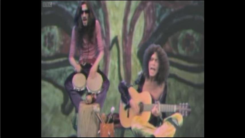

    THIS IS THE VIRTUALDUBMOD SNAPSHOT

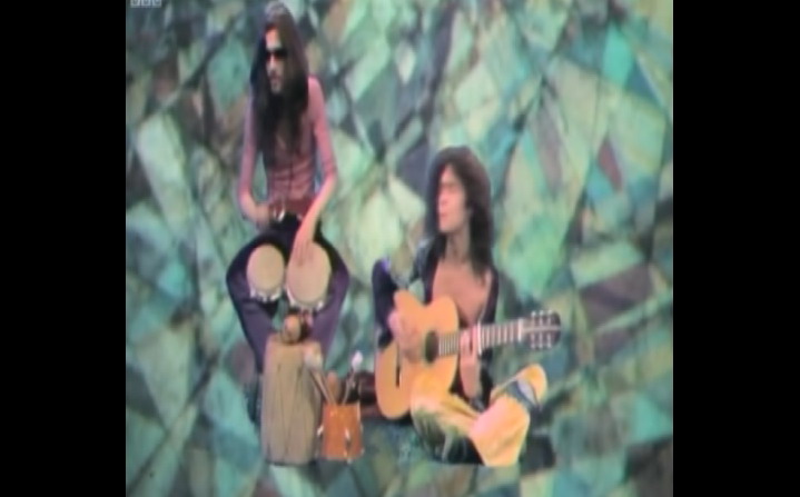

    THIS IS WHAT I AM ACTUALLY SEEING (up to where the picture disappears behind the plastic TV casing - the edges)

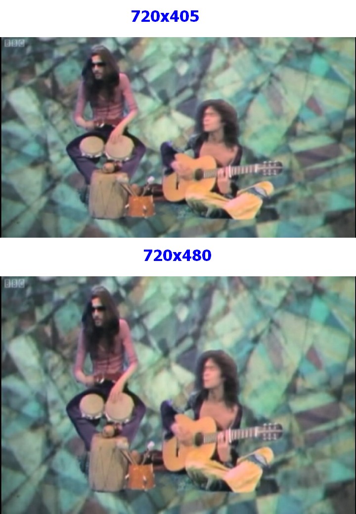

    Hope these pics may help you:

    OK - I figured out where the null filter was and cropped the image to remove black bars and the output window shows the image with the black bars removed and marked the start/finish points...
    NOW I'M STUCK!
    don't know how to save the edited file in virtualdub - it's just sat there!
    What do I need to press or click to save the edited/output image/file please?
