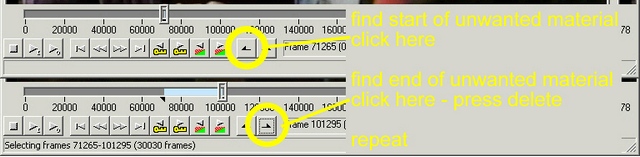

    I suggest that while you have the mpeg in vdub, simply remove the stuff you do not want and save the rest as a single xvid avi.
    Saving several xvid avi segments and trying once again to join them will surely bring unnecessary headaches.

    I can remove that I dont want to have in vdub?
    I have only use vdub to mark that I want to have and save it as AVI
    Join Date: Dec 2005
    Location: none
    mark-in, mark-out, Edit -> Cut, repeat as necessary
    Join Date: Aug 2007
    Location: United States
    VDubMod - And as jagabo pointed out - it is not a complex process
