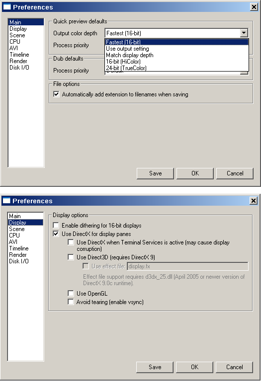

    1) VirtualDub does its own AVI file parsing.
    2) It uses VFW decoders to decompress video.
    3) If the video comes out of the decoder as YV12 or YUY2 VirtualDub does its own YUV to RGB conversion.
    4) To display the RGB data in VirtualDub's input and output panes, it can use DirectShow's Video Overlay feature (only while previewing, not while scrubbing). Or it can use DirectX (newer versions only) or the regular Windows GDI functions. I believe GDI is always used while scrubbing.
    Compared to DirectShow:
    1 and 2) The file parsing and decompression can cause small frame number differences when B frames, packed bitstream, and/or open GOPs are used.
    2) Different decoders may behave differently when there are errors in the compressed data (eg bad downloads). One may crash where another simply delivers a messed up image.
    3) YUV to RGB conversion may differ from program to program. There is the issue of rec.601 vs rec.709 matrices (slightly different colors). And the difference between contrast exapansion (whether IRE 0-100 gets converted to RGB 0-100 or 16 to 235) (slightly different brightness and contrast). VirtualDub uses rec.601 matrix with luma expansion.
    4) Most media players will use Video Overlay by default. Since most MPEG related codecs output YV12 data the graphics card becomes responsible for the YUV to RGB conversion. While scrubbing, VirtualDub will use its own YUV to RGB conversion (#3) and send RGB data to the Windows GDI. This may result in color differences.
    If you are having problems with frame accurate editing, try using MPEG4Modifier to convert packed bitstream to unpacked, or vice versa. That may help.
    Oh, and Video Overlay usually has its own brightness, contrast, gamma, hue, and color controls. So the same RGB data may look different on the desktop (VirtualDub, GDI) compared to media players (overlay).
