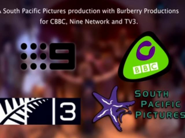

    A small picture on a small screen:
    The image is sharp, the text is crisp.
    The same small picture on a big screen:
    The small image simply doesn't have enough information to look sharp and crisp when blown up to fill the bigger screen.
    If you want a sharp image on a big screen you need to find a high resolution source. Try downloading some of the HD movie trailers from apple.com, or some high def divx files from stage6.com.
