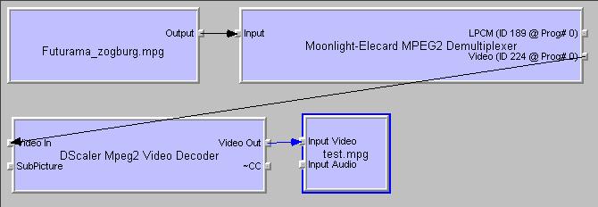

    http://www.zatznotfunny.com/graphedit.html
    Here's my graph in graphedit , the file writer used is mainconcepts mpeg encoder ... that's mpeg to mpeg , not mpeg to avi ... which would be going backwards .
