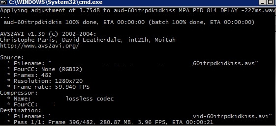

Edit: The following script assumes you are using .M2T source files and have Aspect HD installed.
1) Install Avisynth 2.57 or later http://sourceforge.net/project/showf...ease_id=509414
2) Download and unzip the M2T_preprocessor files from http://www.savefile.com/files/890679

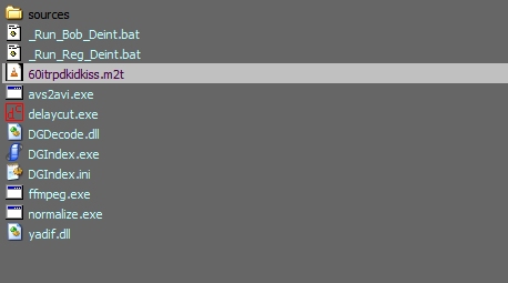

3) Place one or more .M2t files into the same folder as the unzipped files, like this:

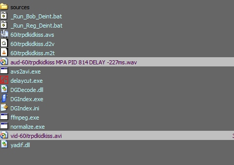

4) Doubleclick on either .BAT file to begin processing. The Bob Deint one will provide a much smoother visual look to your video, but it'll require some horsepower to play. The script will process the audio and video, normalizing the audio and fixing time delays, and deinterlacing and converting the video into the very nice Cineform codec.
5) The ready-for-importing into Premiere files will have an AUD and a VID prefix, just like this:
(note: Don't worry about the "Delay" word in the WAV file. Delay has been automatically fixed)
* Now you'll have a very high quality looking source file to work with. It should look quite nice and the audio volumes of your videos will be the same, which is a great feature.

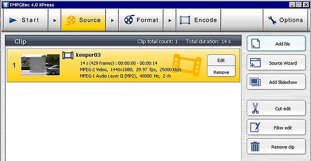

Pre-Processing the M2T file
Add M2T file(s)

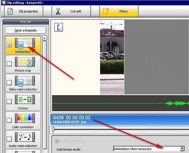

Make Sure Deinterlacing is Set as Follows

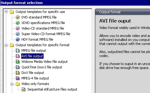

Output to AVI

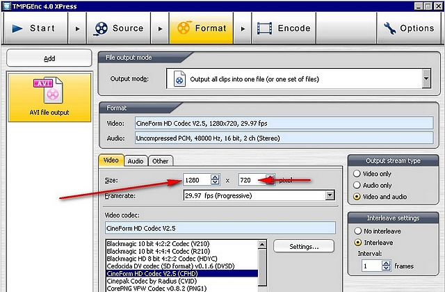

Choose These Settings
And now import into Premiere.
