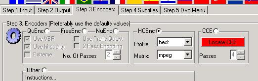

Lastly, yes, the HCenc did 2 passes, each took more than an hour. Is that dual pass a must or I can control that? When I selected HCenc in Dvi2Dvd this setting is not editable to make it 1, see screenshot and thanks for the reply, wondering if I should've tried a different encoder other than HCenc, no experiences at all on this whole process, just learning as I go with the help from all of you guys:

If that's true that will add another process to using Total Video Converter and instead I'd just use the "long" way as described previously.
