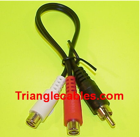

    Or if you don't mind mono, just pick up a Y adapter and use the working channel.
