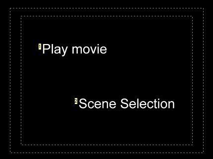

    I'm trying out the demo version of DVD Lab Studio V1.25 right now. Here's what I'd like to do and I hope someone could tell me if it's possible in the Studio version.
    The menu will have 2 options...play movie and scene selection. Play movie will play the entire movie (composed of multiple chapters) all the way through. Scene selection will go to a text only menu. It will allow you to play a specific scene (each chapter will be a scene) and then return to the scene selection menu when that single chapter finishes playing.
    So far I've been able to set up the main menu, but when using scene selection, it continues playing the rest of the movie, going past the end of the chapter. While searching online, someone mentioned using chapter branching. According to the version comparison, this can only be done in the Pro version. Is there a way to do it manually in Studio? I know there is a "return to previous menu" option. I don't know where it is, but I read about it. The question is when does it return to the previous menu? So far, not when I'd like it to.
    Also, the scene selection options all contain cheesy images. I want text only menus. Is this where creating my own "style" comes in? I read a little in the help file, but didn't understand it.

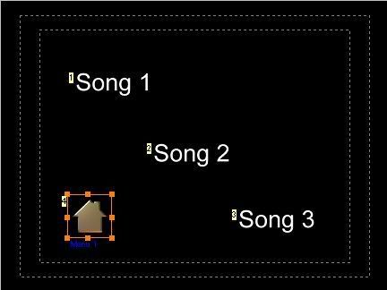

    Making text version of scene selections are easy. Add a new menu, place the text, define the links to chapters. Don't forget buttons to navigate to the next/previous menu and to the main menu. It can be a bit of a pain when you have a lot of chapters.
    I've taken both of your advice and created new menu pages with text linking to the various chapters. This works nice and wasn't too complicated. I was trying to use the automated option of "create scene selection from chapter list," but then I couldn't use text menus. Anyway, now I've got that figured out. I've got a whole 3 hours of using the software under my belt after using TDA for the past year. It's a bit different.

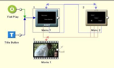

    This is weird. I put the "home" image on the scene selection page to return to the main menu, but when I played the DVD I couldn't navigate to it with the arrows on my remote. The image was item 4 on the page and would work if I pressed number 4, but it would not highlight if I continued to push the down arrow button on my remote. Here is my simple example:
    Main Menu
    Scene selection
    Connections
    Do you see anything that would make the home image not be selectable?

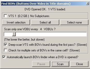

    Now I'm going to research PGC Edit and IFO Edit to see if I can return to the scene selection menu after each chapter.

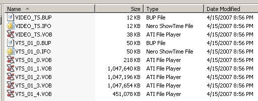

    The approach depends on what the dvd looks like after authoring with your dvd software. Can you list the file names in your VIDEO_TS folder (and their filesize)
    Regards,
    George
    George,
    I'm going to have to do some work before I can give you that info. I installed the demo about a week ago and have been messing around with a short practice clip just to see what I could do with it.

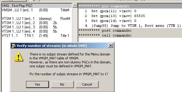

    I think I followed your instructions exactly as you wrote them, but instead of returning to the scene selection menu after each chapter, it returns to the main menu. So the functionality is there, it just returns to the wrong menu. Can you have another look at your instructions to see if anything jumps out at you? Not knowing about this stuff, I tried a few different settings on my own, only to make non-functioning discs.
    A few side notes that may or may not mean anything. When I Open a DVD to start working in PGC Edit, I navigated to the folder containing the video_ts and audio_ts folder. This dialog box came up about verifying the number of streams.
    One time I said yes and another time I said no. Either way created bad discs. Immediately after that, this dialog box popped up.
    I clicked cancel and continued with your instructions.

    ok, I didn't realize you had multiple scene-selection menus.
    Looking at this comparison chart, it appears the Studio version has an option to "Return Last Menu"
    http://mediachance.com/dvdlab/comparison.html
    In that case, add the "Return Last Menu" to your project, and make the Movie connect to that object.
    Then follow the first instructions (do not do the second instructions about deleting that GPRM command).
