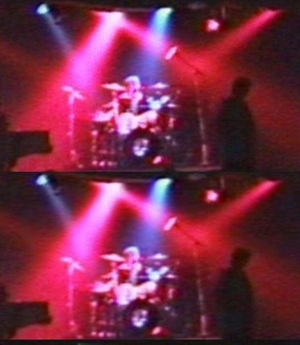

    IF you are ever going to convert the footage to another format in the future ie .mp4, DivX etc. you will get better results from the larger 720x480 frame size (at an appropriate bitrate of course)
    I'll always cap at 720x480, I have no choice I use a Canopus besides the fact I don't want to lock myself into a lower resolution which brings me to the point of my little experiment. The golden rule is you don't want to scale video up, bearing that in mind why would that not apply to a player scaling as well and if we must scale wouldn't a higher resolution video scale better.
    Anyhow here's the specs for both of the following examples, the original source was VHS capped as DV-AVI. From there I madd a 720x480 8000kbps and a 352x480 4000kbps. I don't have a source for directly making 352x480 caps but I don't see why just encoding from a DV-AVI will make any difference.
    Anyhow here's a comaprison that was scaled using PowerDVD ver. 4 (note that it's cropped), the full screen capture was 1280x960 the full screen captures and the video they came from are available in the following post.
    The 352 is on the bottom:

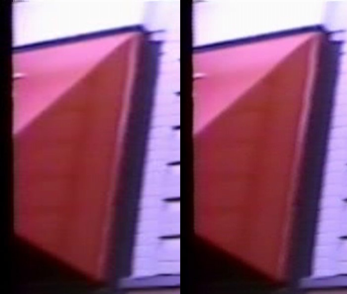

    So i thought aha! It does make a difference so I ran another test with a much better video.
    352 on the left:
    That really doesn't have much difference at all except for a little bit of the red bleeding into the black so I'm wondering if maybe it's just the player. It is quite old and I appreciate it someone tried the first video.

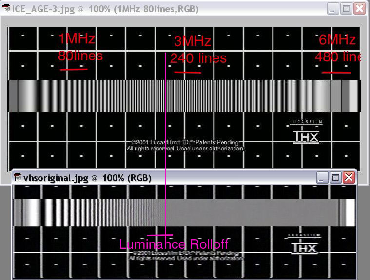

  10. Gshelley61 may be able to comment further on this but it seems to me several years ago, I was trying to duplicate his captures of THX test patterns using Cineplayer while he was using PowerDVD. We could not get results that matched. Lordsmurf and Vhelp suggested using VirtualDubMod to extract stills. We could get consistent matching results then.
    If you use a THX test pattern like this multi-purpose pattern, it may easier to compare results. I have recorded the pattern to a VCR for that purpose. Here is the original THX pattern,
    The main problem with that test pattern for this subject is lack of diagonal references. 352 encoding doubles the effective pixel width causing stepping on diagonals. VHS is softer so it will be less a problem than with sharp sources. The other issues are motion effects and blocking at various bitrates with moving video.
    Expect VHS frequency response to be in this range
    (picture shows DVD top and VHS bottom).

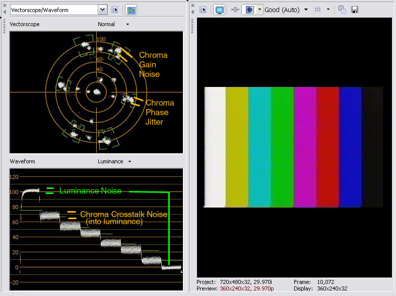

    Most consumer capture cards oversample analog at 27-54MHz to avoid the need for expensive low pass analog filters. 720, 704, or 352 are downsampled with simple digital filtering. This keeps the cost down but allows capture of high frequency noise out to 27MHz that would have been filtered out with a classical low pass filter at 6MHz.
    VHS could benefit from a sharp 3MHz low pass luminance filter to keep the chroma subcarrier crosstalk out of the capture. Cost is the issue.
    As it stands VHS chroma crosstalk noise into luminance is substantial.

    A VCR is full of chroma noise just above 3MHz. It is worse for NTSC where the chroma subcarrier is at 3.58MHz vs 4.43MHz for PAL.

    I don't agree that 352x480/576 is adequate for broadcast NTSC, PAL, S-Video, Hi8 or
    laserdisc. You can use it for data reduction but quality will suffer in the compromise.
    Broadcast NTSC is a special case. If a quality comb filter is used to decode NTSC, then the capture will have detail out to 4.2 MHz. If not 352x480 may be adequate but not ideal.
  24. Preservationist davideck's Avatar
    Join Date: Feb 2003
    Location: USA
    Broadcast quality resolution (~300 lines) is all that is necessary to easily notice the difference between 352 and 720 capturing. Everyone should do an A/B Comparison test on their setup with their sources to see whether they notice a difference on their display devices.
    A great input source for this test is the TV Guide Channel. The one in my area has a stationary legend (with a slowly changing current time character display), a scrolling character display below the legend, and picture content above (including a stationary TV Guide logo). Make one recording at 352 and one at 720, and then skip between them during playback. You can also compare the recordings to the original live source. The loss of detail can be spotted by focusing on the current time character display and the TV Guide logo as you switch between the images.
    The difference in detail may seem slight, but keep in mind that it represents original picture content that is being lost. It is not noise. It is not sharpness. It is detail. Once it's gone, it's gone.
    There is a good reason why ALL DVD Recorders capture at 720 on their higher quality settings.
    Life is better when you focus on the signals instead of the noise.
