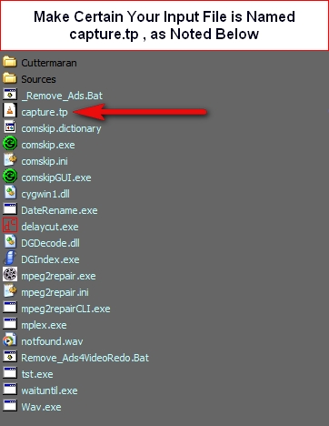

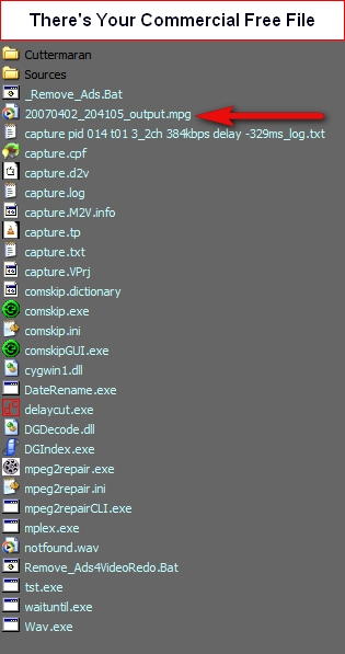

    Here's a script which will detect and remove commercials from your recordings. It will output an Mpeg2 program stream file, which you'll be able to convert/transcode/etc to your format of choice with your favorite software. Your source TS file won't be modified in any way.
    The script includes features to ensure good A/V sync on the resulting Output.mpg file. This includes repairing the Source TS file before running the commercial detection. If you don't want to do it that way, modify the batch file to suit your purpose. I wouldn't recommend it, however. It is worth the extra time and temporary disk space. I wouldn't include it if it wasn't important.
    This procedure works amazingly well, but it will take a fair amount of time to execute. An hour long TV program will take around an hour to process - more or less time depending on your CPU. I've included a simple "waitfor" timer which you can modify to run the script at night.
    Requirements:
    .NET 2.0
    Lots of Temporary Disk Space
    Procedure:
    1) Download and unzip the following
    http://www.savefile.com/files/1022186
    2) Place your Transport Stream File into the same folder as the Unzipped Apps
    3) Double Click the _Remove_Ads.Bat file to Run

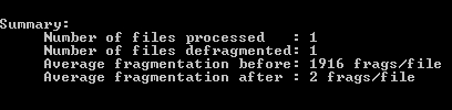

    Defrag your drive frequently if you use this script. There are many files being created, erased, and created.
    I like Jkdefrag , as it can be scripted and works very well. http://www.kessels.com/JkDefrag/
