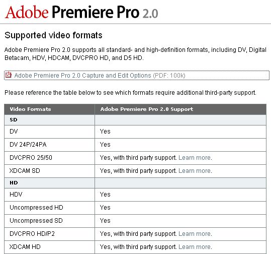

    Premiere Pro supports* uncompressed (YCbCr or RGB) and native DV editing. Yes you can import MPeg2 and use all the Premiere features. The problem with importing MPeg2 is sluggish performance and long timeline renders. If all you are doing is cuts editing, you might as well use a Womble product. If you are doing serious editing, better to decompress Mpeg2 or use the Mainconcept MPeg2 timeline Plug-In
    ( http://www.mainconcept.com/site/index.php?id=7850 ).
    * Premiere Pro native formats
    http://www.adobe.com/products/premie...edformats.html
