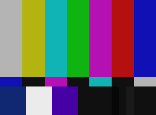

    The most important issue for you is to adjust the black level. You need to use a test pattern like this Macbeth chart:

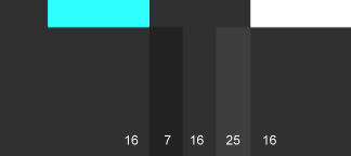

    The part to pay attention to is the lower left corner:
    I've brightened it up here so you can see it better. Ajust your TV so that the bars labeled 7 and 16 are totally black. The bar labeled 25 should just barely be visible.
    If you try to make your own DVD using this pattern be sure that the MPEG encoder doesn't contrast compress when it converts to YUV. In TMPGEnc you can achieve this by enabling the "Output YUV data as Bais YCbCr not CCIR601" option. In CCE you set the "Luminance Level" to "0-255".
