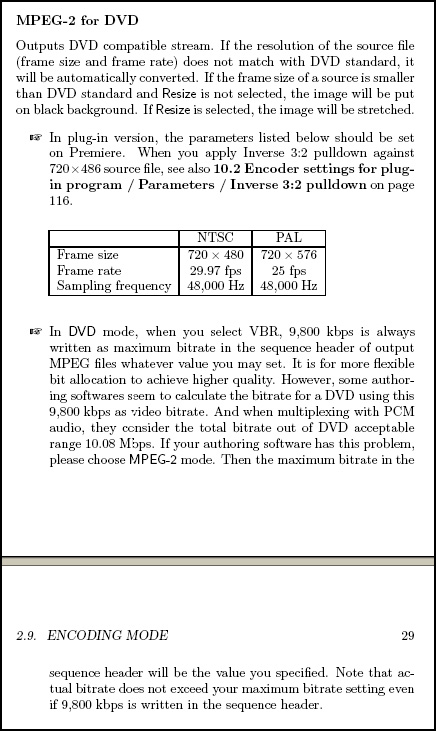

    Here is a cut and paste from the CCE PDF file:
    In most cases you don't want all that! For instance if you are doing Half D1 instead of Full D1. Also some DVD authoring programs might have issues with the header being set to the MAX bitrate etc.
    In short it is better NOT to checkmark that option.
    - John "FulciLives" Coleman
  10. And if you keep it checked and at the same time use the RePAL filter, or are trying to do a PAL2NTSC conversion for 25fps and 720x480, it's going to screw you over. Also, as FulciLives mentioned, checking it is going to set the max bitrate as 9800 in the headers, no matter what it really is, and some authoring apps (like TDA) whine about it, and cause some users unnecessary anxiety. If you do it correctly in the .avs, there's no need to check the box, and checking it can sometimes lead to unforeseen consequences.
    Thanks.Thanks.
    Aaaaaaaaaah. That's why TDA always gives that error (well actually it's more of a notice) about the total bitrate being over the limit even though I've used max bitrate of 8000kbps. It still always accepts the video and just warns that the dvd may be out of standard. But that's not a problem seeing as I know that the bitrate is fine. Right ?
    Does unchecking the 'DVD' option change anything else that may make the mpeg-2 non-dvd-compliant ? What else is needed for the MPEG-2 to be dvd-compliant besides bitrate/resolution/GOP's ?

    Well you picked the one SIMPLE thing both manono and I said.
    There is more to it than that. Look closer at both of our comments and just accept that you should NOT checkmark it.
