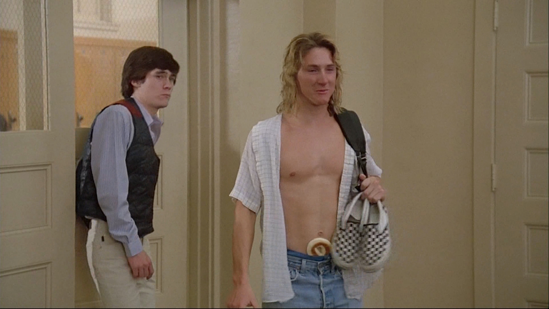

    Example of some bad mastering.
    "Slow Times at Valley College" - More grain than health food store bread
