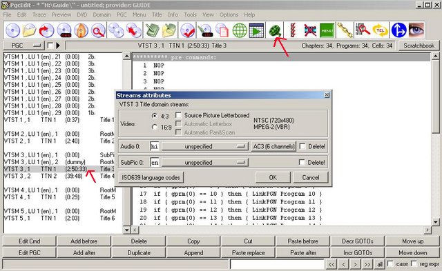

  15. Hi-
    Both DVD2AVI and GDindex display the frame ratio as 4:3.
    Are you talking about the picture as shown in DGIndex? It's showing the raw unresized video as created. It's showing the 720x480 (3:2) video. When you run the preview (File->Preview) or save the project file (D2V), an information window opens up which shows the DAR. If 4:3, that 720x480 video gets resized to 640x480 (480 x 4/3 = 640) at playback. If 16:9, that 720x480 video gets resized to 854x480 (480 x 16/9 = 853.333) at playback.
    The original dvd plays like that, on both the comp and tv.
    The DAR is set in 2 places on a DVD, in the IFOs and in the video itself. DGIndex just reads the video, so if it's wrong there, it'll show it incorrectly. If the video has it wrong, but the IFOs have it right, the DVD will still play correctly, as it's the IFOs that DVD players read.
    If having the wrong DAR in the video bothers you, or messes you up when editing, you can correct it using DVDPatcher or ReStream. It shouldn't mess you up when encoding as long as you set it up properly for the encode (and if you don't listen to me telling you to encode for 4:3 when you know damn well that's wrong).
    And yeah the TMPGEnc encoding didn’t work. The image is squished in all players.
    So you can try and correct it without reencoding, and then reauthor. If you've already authored it to DVD, you can do the same thing your source DVD did, just make sure the IFOs are set for 16:9. This can be accomplished using IFOEdit or PGCEdit. I think PGCEdit is the easier of the 2 with which to work.
    Open the DVD in PGCEdit, highlight the video (make it grey), click on the green roll of film icon in the top row, and in the new screen, change from 4:3 to 16:9 Automatic Letterbox. OK, Save, and test it out. If it checks out, delete the backup PGCEdit made. If you somehow mess up, replace the IFOs PGCEdit backed up for you and start again
