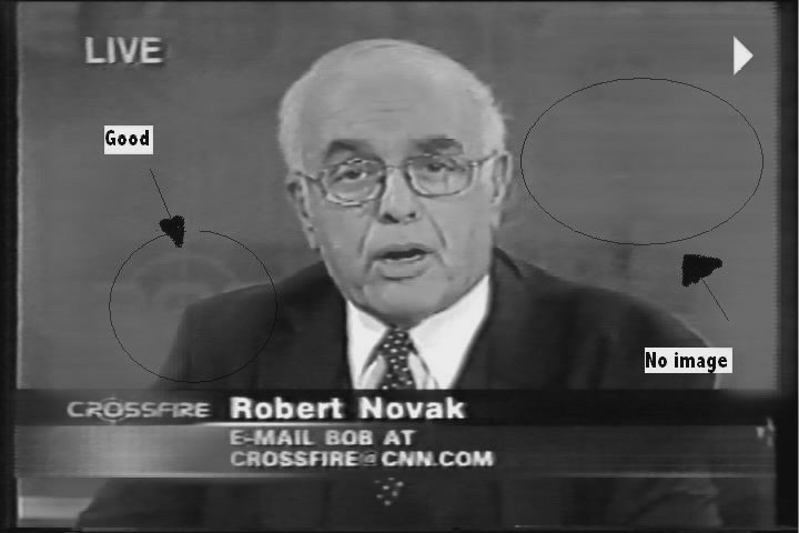

    I was checking one of my videos captured from tape, they look better then with the Dazzle I have to say, in a way there isn't sound distortion coming from the capture device anymore when the tape jumps due to poor recording "skills"... the picture quality seems just a little higher and it doesn't disconnect whenever I turn on the tv. However even though it all looked fine... while watching one of my videos on the pc to compare it with the tv same scene apart from video quality I noticed there was something missing in terms of video content... The text "crossfire" does not show in the pink background as the picture shows below...
    However I know now the information is there, because I soon as I output it to the TV using WINDV.... voala! is there! so my question is:
    1) why is not shown on my PC (even with interlacing artifacts...) but very visible on TV!
    I thought the only displaying difference was the interlacing artifacts not missing content!
    2) how do I view this text on my PC... I imaging better interlacing methods have to be used...

    When most programs convert YUV to RGB for display on the computer, they stretch the contrast so that luma values (Y) from 16 to 235 are to coverted RGB from 0 to 255. Values below 16 are clamped to 0, values above 235 are clampped to 255. The crossfire logo in the upper right has luma values all above 235. These will usually show up as slightly different intensities on TV but the conversion to to RGB leaves them all maxed out at 255.
    Your capture is too "hot". If your capture device has proc amp controls try turn the brightness and contrast down.

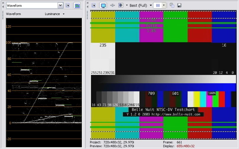

    The image as shown has been clipped at white 255 and black at 0. All detail around white or black is lost. Normal range for DVD should be 16 black 235 white with some overshoot to 255.
    Anything driven below digital 16 (0 on the scale shown) will be invisible on a properly adjusted TV. Overshoots to 255 will be visible but the 235-255 area is intended to carry little energy or the AGC will darken the entire image.

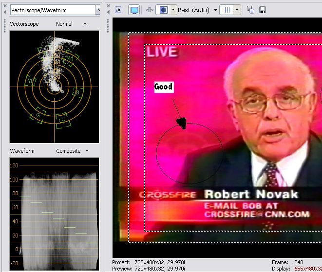

    Also chroma saturation on that image is severely overdriven. Back off on chroma.
    Composite chroma should not extend above 100 or below -20 at full saturation.

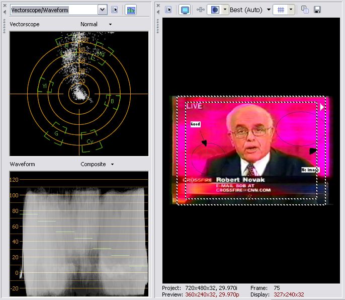

    Extending the range on chroma measurement shows that chroma was either captured or processed to the point of saturation. Once it gets this hot, there is no recovery. All you can do is salvage what is left.
    In Vegas, using "levels" filter set white and black to nominal. Next using "HSL" filter pull saturation down into real world levels. Results (right side) are better but not optimal.
    Bottom line: Clipping white, black or chroma saturation produces unrecoverable errors.

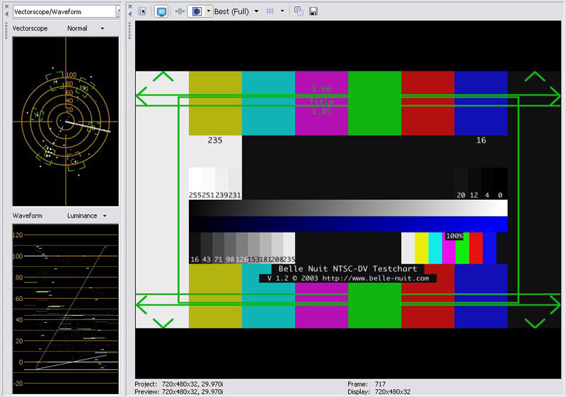

    Think of 8bit digital video capture as a gate. It wants 220 levels for luminance from 16=black to 235=white but reserves 0-15 for error recovery (video is very sensitive at the black end) and 235-255 as protection from overshoot (overexposure).
    Black errors cause problems ranging from black crush (i.e loss of detail in black) to washout (i.e. turning black detail to gray detail). The eye is very sensitive to black level.
    At the white end, one tries to maintain a proper exposure but some areas of the picture like sky or stage lights will always be brighter than the rest of the picture. If you hard clip these to 235, electronic circuits start to ring and cause instability. The area from 235 to 255 is there to buffer and separate the effects of these bright spots. As said above, you only want worse case overshoots in the 235-255 area or the automatic gain circuits in capture devices or TV sets will darken the picture if too much video pushes into this range.
    Chroma saturation limits are also tight in 8bit and tighter yet for YV12 video.
    So what caused your VHS to overdrive the computer capture?
    - recording was hot when recorded.
    - playback was hot out of that VCR.
    - capture settings were too hot.
    By hot I mean at levels that exceed the ability of the device to capture to levels 16 to 235 for luminance and 128 levels for CbCr
    Sampled data may be in 8-bit (0-255) or 10-bit (0-1023) format.
    Y : 8-bit : 220 quantization levels, 16=black, 235=white.
    10-bit : 877 quantization levels, 64=black, 940=white.
    Cr, Cb: 8-bit: 225 quantization levels, 0 signal = 128, 128 signal = 255.
    10-bit: 897 quantization levels, 0 signal = 64, 128 signal = 960."
    http://www.osti.gov/bridge/servlets/...ble/358799.pdf
    Legal 8 bit luminance values are shown in this test pattern. If your monitor is properly adjusted, levels above 235 should appear whiter than white. Levels below 16 should look just like 16 but you should see level 20 as just slightly brighter..
