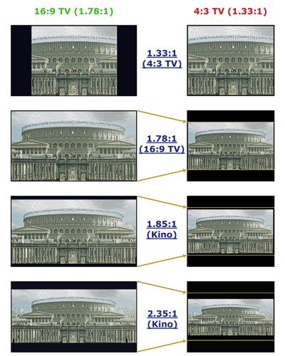

    Thanks for your answer. So if I watch DVD with 1366x768 TV then I will watch 'fat' people? I just wondering why they choose 1366x768 and not 1024x768 that is common in computer. Also if I watch widescreen DVD would the TV 1366x768 try to maximize the width and crop the height?
    Also what will happen if I watch normal 4:3 cable network? Would I have more 'fat' people or will the TV have two pilars on both side to preserve 4:3?

    1366x768 is "wide" WXGA and intended to display at 16:9. The image is scaled to 1366x768 through interpolation. This similar to the "full screen" mode on a PC.
    http://en.wikipedia.org/wiki/Wide_XGA
    High definition television is all wide format. When movies are shown that exceed 1.78 to 1 then letterbox is used. When 4:3 aspect is shown, "pillars" are normally shown left and right. Users have the option for a wide stretch (fat people).
    Picture quality will depend on the source.
