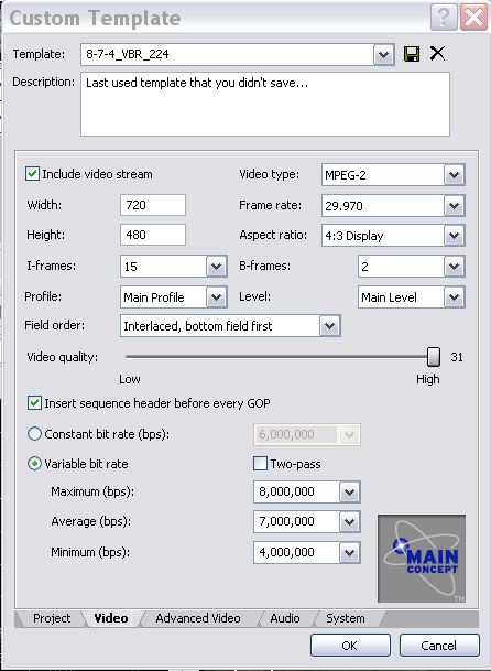

    I am somewhat new to this. When I go into Vegas to render, I see where I can select the mpeg 2 choices, and when I get into the template, I can select dvd, widescreen, ect, ect, but where do I change the bitrate?
    Right here (under render as - custom)
