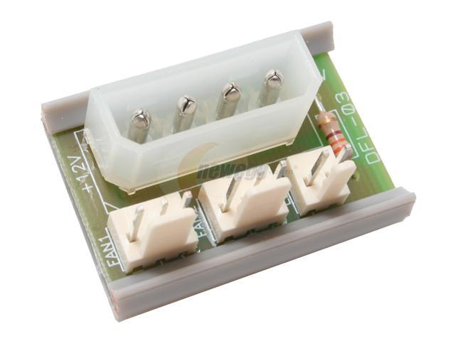

    You can use multiple adapters to connect a device to a power connection on your motherboard or powersupply with no effect on the device or the power consumed.
    In your case I would buy two of these adapters or something similiar that allows you to connect more than one fan to one Molex. I have used this connector alot. The computer I am typing this on has one of these stuck to the rear wall of the tower powering two fans.
    Sooo apparantly, Newegg doesnt/wont ship to canada.
    Too all you canadians in here, any one of you know where I can order a couple of those adapters? I have called 5 computer stores in the Ottawa area and none of them carry this item (well, one has it on their site, its out of stock, and they cant order anymore .. wtf??? .. take it off your website then, losers).
    Anywho .. anyone know if a place in ottawa or in canada where I might be able to get the part mentioned above in ROF's post?

    Thanks for posting that connector ROF. That would help to clean up the wiring in a couple of my computers.
    I wish I could find a place in Canada, more specifically Ottawa, to buy these.
