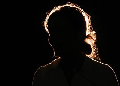

    What is missing is a backlight. The purpose of the back light is to add to the 3D illusion by differentiating the subject from the background. Ideally the backlight is mounted above and behind the subject and is visible only accross the shoulders and hair. Barn doors are used to avoid spill on the back wall. Here are some example pics I pulled off the web.
    No backlight
    With backlight (no fill)
    Backlight only
    The three point lighting concept also uses the fill (wide dispersion) to light the scene and a key light (~50% brighter) to add contrast to one side of the forground subject. You can fake a key-fill with your halogens by setting the fill side back a few steps vs. the key side. Your current lighting already has one side brighter.
