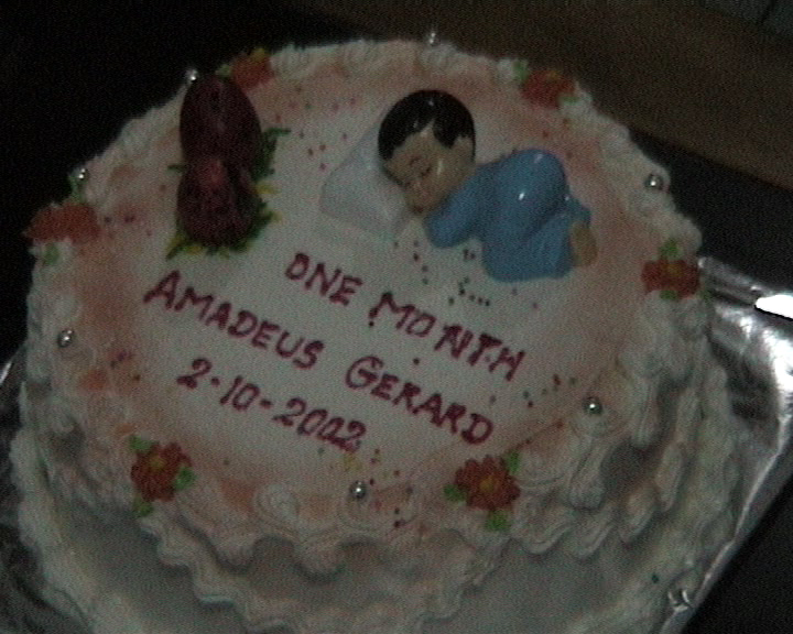

    Hi all, I have mini dv clip that has a noise like high ISO noise in digital still. It was capture in low light mode. I plan to use Avisynth. Can anyone suggest what is the best noise removal plug in for this? A one frame capture is included for your analysis.

    I would use Convolution3D with avisynth for this, although from such a reduced still it is hard to see just how much of a problem you have.

    Thanks for the tip. I grab it from windows movie maker. Any idea how I can grab bigger resolution?

    I always recommend WinDV for transferring from miniDV to PC. It'll give you a DV AVI file at the resolution and audio quality that was used during shooting the video clip. In most cases, this will be full D1: 720 x 480 / 576 (NTSC / PAL).

    open it in virtualdub or virtualdubmod and save a still. That will give you full resolution

    OK here is bigger grab. I tried convulation 3D but the audio become very slow. Any idea why?

    try MSU noise reduction filter - works very well ...

    It will only be slow in preview. All noise reduction filters take a heavy processing toll, so don't expect to see it in realtime with audio in most cases. As it is only the preview, it is not a concern.

    My advice is Convolution 3d or degrain median
