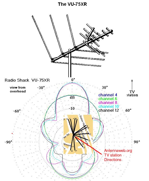

    ** How do I adjust my antenna according to the chart from www.antennaweb.org ??
    ** I don't understand this degree business. Can someone explain more clearnly ??
    The specs:
    ** Antenna: Radio Shack brand, VU-75XR VHS/UHF/FM
    ** The pie chart states, GREEN and 75 mile range
    ** HDTV Receiver: by Hisense, USDigital
    ** most channel distance from me are 41 miles or less

    I found this pattern for the VHF stations for the VU-75. For DTV(SD and HD) you would mostly be looking at UHF stations. I overlayed an antennaweb station direction graphic.
    Stations H,I,J,K are on the strongest lobe. A,B,C,E may work off the side lobes. G and F would be fairly strong off the back . D would be the weakest.
    Normally you point the antenna to the weakest of your desired stations (factored by distance and transmitter power). In some areas, DTV stations operate at different power levels during the day. This is more likely in small markets.
    The UHF pattern is more likely to be focused forward. That antenna looks too small for 75mi.

    To vHelp:
    As for your concern about the "degree business" - when I had a rotator installed on my outside antenna the installer had to orient the antenna first towards magnetic north. Then tighten connections/bolts to the rotator.
    Inside near my tv, the dial allows me to then point the antenna in any direction at various degree marks.
    That antennaweb.org site should also tell you what channels/stations are available in your area.

    If it were me, I'd use antennaweb.org to locate the probable channels, their direction and distance. Then I would manually program those into the box. Then I would fiddle with aiming the antenna to get the most stations.
    If the stations are located in different directions, then multiple antennas with a combiner or a rotating motor will be required.
    This is so 1950's
