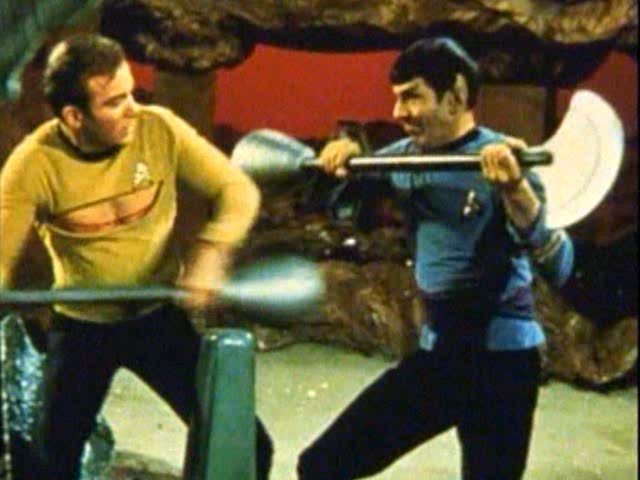

    Here is an example picture to help illustrate.
    STAR TREK
    The image above is your standard 4:3 image and would completely fill a 4:3 TV so that you see what you see above.

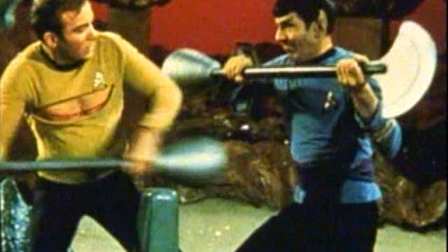

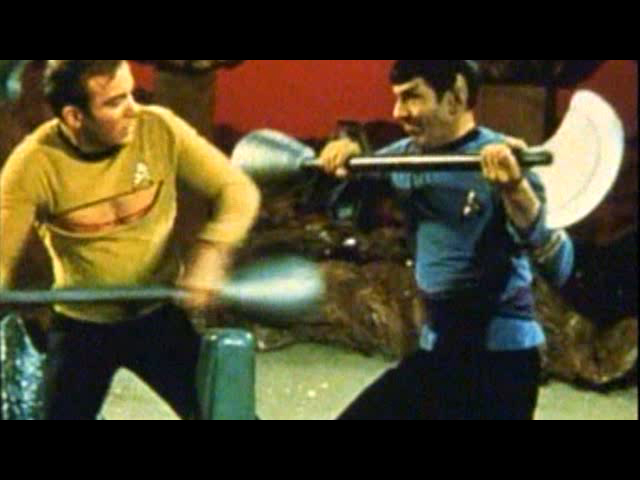

    If you use my first method ... where you chop off the top and bottom in order to convert to 16x9 WS ... this is what you see:
    Method #1 on a 4:3 TV
    Method #1 on a 16x9 WS TV

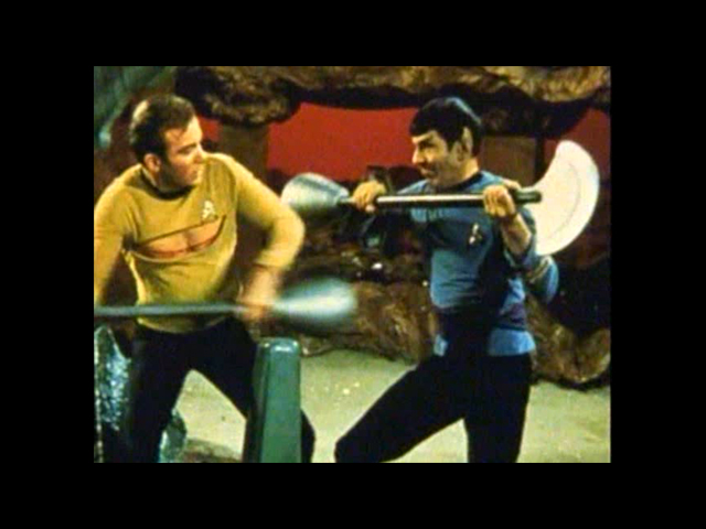

    If you use my second method ... where you resize without any cutting of the image in order to convert to 16x9 WS ... this is what you see:
    Method #2 on a 4:3 TV
    Method #2 on a 16x9 WS TV
