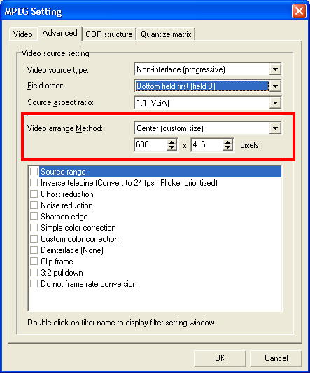

    Alternate method using only TMPGEnc (slower and lower quality because TMPGEnc's resizing isn't as good as AVISynth):

    Use FitCD to determine what size you need then use either of the two methods suggested earlier. TMPGEnc's "center custom size" or resize with AVISynth.
