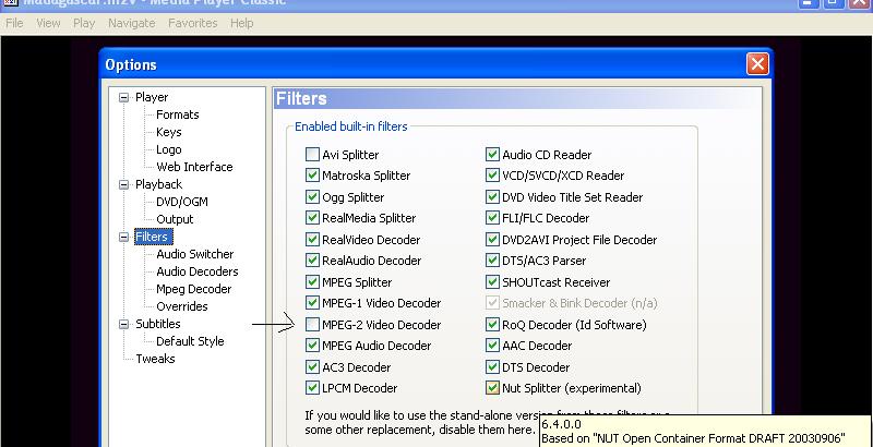

    Currently I'm having a problem playing back video in Media Player Classic. All video formats playback except for M2V. Its M2V video that I've convert so that I can author DVDs. M2V used to playback perfectly. Below are images of the settings that I think would effect playback, maybe I can get some feedback to get my playback to work again.
    As you can see the file is playing but there is no video.

    Edit: Well I tried and uninstalled the ATI and Creative drivers and reintalled them. I reinstalled the ATI twice, once via the CD that came with the card and the second time via the ATI drivers from their web site. There is still no video output. I even tried a system restore from a System Checkpoint...that had no success. I also uninstalled Cole2k Media - Codec Pack V6.0.4 Advanced figuring that may by slight chance fix it, still no video output. I'm totally stumped as to what is causing this problem. I installed the latest DX9 and still no video. Video plays back perfectly in PowerDVD. I just like Media Player Classic because it'll load the audio file with the video that way I can see if the audio is in/out of sync with the video.

    In the image above there is the MainConcept MPEG Splitter, I don't recall that ever being there when Media Player Classic was able to play M2V files in the past. I uninstalled all MainConcept programs on my computer. The MainConcept MPEG Splitter is not in the Add/Remove Programs list. How do I remove it from my system because I kinda have a feeling that that's what's keeping video output from showing.
    Edit: Thanx for your help, Sartori. I finally got it to work I used DirectShow Filter Manager and removed the problematic filter, it was the MainConcept MPEG Splitter filter.

    I have the same problem with Media Player Classic playing M2V files. I installed the Directshow Video Manager but I do not see anything about Mainconcept. Not sure what I should try next to solve my M2V woesssss.

    Ahhh nevermind, I found the trouble. I finally remembered I had selected Filters, and selected MPEG-2 Video Decoder, and now that I unchecked it, M2V files play fine now.
    Hope this helps anyone else who might have checked these filters by mistake, not sure why MPC wasnt working but its a fix for the Codec-Newbie like me.
