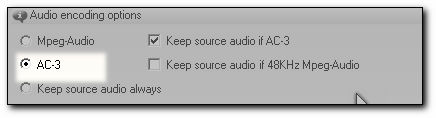

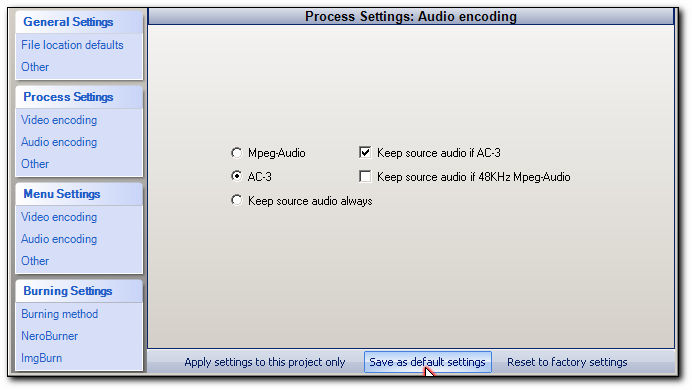

    Well you have produced an NTSC DVD with mpeg audio. Now in most cases this is ok but some players are very strict about the DVD specs here.
    In this area the DVD specs state that for NTSC DVDs you can have mpeg audio but at least one of the 8 audio streams must be AC3 or PCM.
    So i suspect your player is taking that to the letter of the law. The solution? Change the audio settings to AC3.
    I would recommend the following for you:

    Still mpeg-audio. Make sure AC3 is checked:
    VOB2MPG PRO, Extract mpegs from your DVDs - with you in control!

    Yup. My settings look exactly like that. I just opened up SVCD2DVD and looked to make sure.

    Are you reloading a project file? If so check your settings after that.
  25. Member
    Join Date: Feb 2005
    Location: Willow Creek, CA
    You guessed that right. I had made those settings you showed as the default but hadn't changed it for that specific project so, of course, it just did the same thing again.
