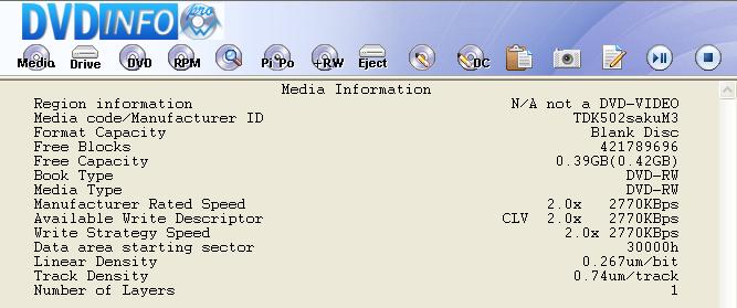

  5. It was mentioned that these disks do not read in the PC. Do you mean they do not play on a software player like PowerDVD or that the PC does not recognize them at all?
    If it does not play but the PC recognizes the disk, try downloading DVDInfoPro from the Tools section to the left. It is freeware and will allow you to check the manufacturer code, erase, and format the disk.
    If this is TDK dvd-rw X2 media, you should get media information like this,
    If I quick erase with DVDInfoPro, the Pioneer 531 will automatically initialize the disk upon insertion. If I quick format it, the 531 will say " cannot play this disc", but the disk can be manually initialized and will work again.
