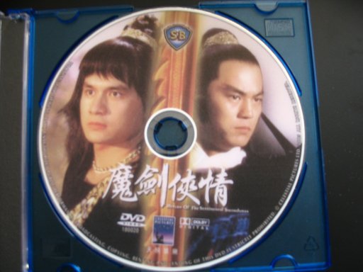

    Here's a picture of a MAXELL 8X DVD+R PRINTABLE media. As you can see it is hub printable.
    Join Date: May 2004
    Location: United States
    Hrm, "Demon Sword" something....
    Oh yeah!!! hub printables are the way to go!!!!!!!
    How come you left the white ring around the center and outer edge ??
    Nope the movie title is called, "RETURN OF THE SENTIMENTAL SWORDSMAN"
    I print mine right to both edges so there is no white
    I'm still a novice when it comes to dvd disc printing with my epsonr200. I don't do many dvd disc printing. I haven't even used up half of my ink yet. I didn't realize you could print to the edges. I have some discs already burned but I never have the time to print them out.

    Originally Posted by Fandim
    Budz, try using 21 inner, and 119 outer.
    Yep, i'd start there, if there is still white in the center just bump it up another mm, i actually do 22 inner 119 outer.
