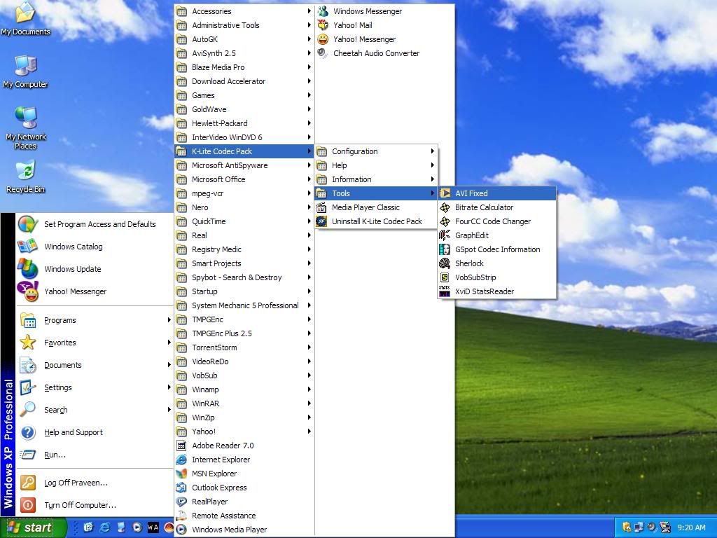

    I've an AVI file. Just to test the tool present in the K-Lite Mega Codec Pack, I opened the AVI Fixer tool, and gave an AVI file as an input and asked it to Fix.
    After fixing the AVI file, the file became totally corrupt. Now, anyone please help me undo this fixing. I want back my original AVI file.

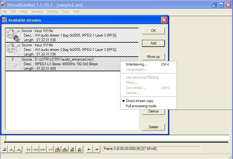

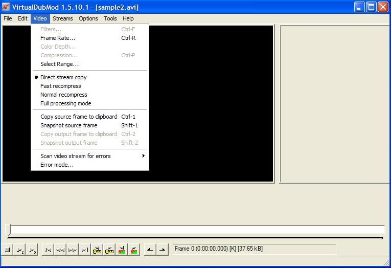

    Open sample1.avi in virtualdubmod. Go to Video > Direct Stream Copy, then go to Streams > Stream List. You should have something similar to the following:
    Click the Disable button, so you get the following:
    Now click the Add button, and add your audio-boosted MP3. you should get the following:
    Now right-click on the audio stream you just added, and confirm that it is set to Direct Stream Copy:
    Once you are satisfied, click OK, then go to File > Save as AVI and save your new AVI. THis should take the video part of your 700MB sample1.avi file, discard the non-boosted audio, and add the boosted audio, and should result in a 700MB AVI file with boosted audio !

    Thx for the great idea. This is what I did after opening sample2.avi in VirtualDubMod's Stream List :
    Ensured Direct Stream Copy :
    Noticed that there are two streams(as you guessed) when sample2.avi is opened.
    Disabled both the streams
    Added the boosted audio file and checked for 'Direct Stream Copy'
    Now I saved the AVI file. The magic worked. I got a 701MB AVI file with boosted audio.
