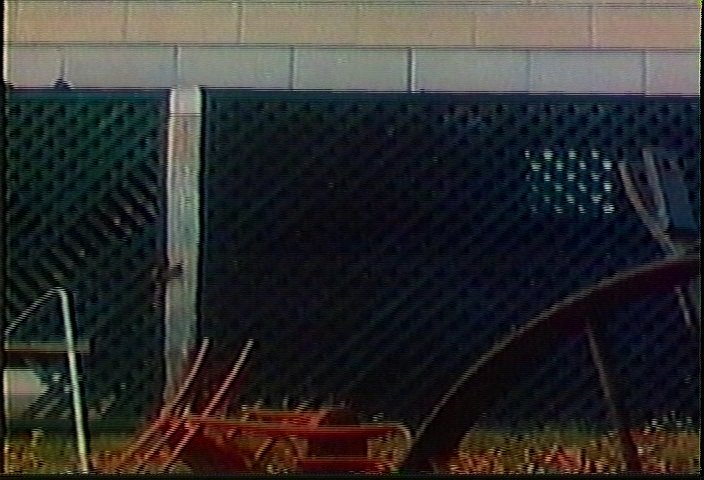

  6. Does it look anything like this,
    versus this,
