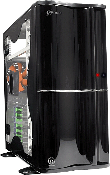

    And my case is also new...this one:
    Features: High Efficient ventilation: Dual 12cm silent fan in front & rear, 9cm fan on side panel. Tool-Free when installing 5.25" & 3.5" device. Transparent X type side panel window. Dual USB 2.0, IEEE 1394 Firewire, Audio & Speaker ports. Retractable foot stand.
    Specifications: P/N: VB1000BWS. Drive Bays: 11. External: 4 x 5.25", 2 x 3.5". Internal: 5 x3.5". Case Type: Middle Tower. Color: Black. Side Panel: Transparent X type side panel. Expansion Slots: 7. Motherboards: Micro ATX (9.6"x 9.6") & ATX (12" x 9.6"). Dimension: (H*W*D) 495 x 210x 478 mm. PowerSupply: N/A. Cooling System: Front(intake): 120x120x25 mm, 1400rpm, 21dBA. Rear(exhaust): 120x120x25 mm, 1400rpm, 21dBA. Side(intake): 90x90x25 mm,1800rpm, 21dBA. Material: Chassis: 0.8 mm SECC. Front Door: Plastic. Container Load: 346 pcs / 20' container, 714 pcs / 40' container, 802 pcs / 40'HQ container.
