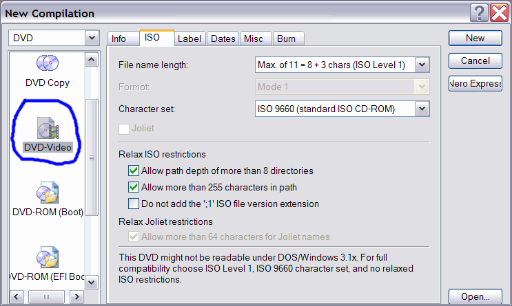

    Ensure you select the DVD VIDEO compilation as shown:

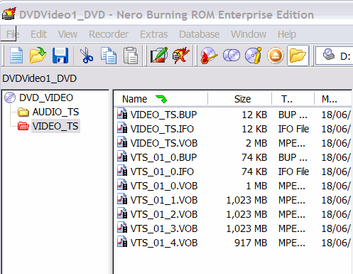

    Ensure all files are located within the VIDEO_TS folder. For compatibility, ensure the title of the dvd disc is in ALL CAPS with no spaces:
