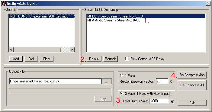

    ... or just demux it in Rejig:
    1. Select your audio stream here.
    2. Click Demux button. This will prompt you to save the audio file somewhere.
    3. Just overtype with whatever filesize you wish to hit. I'd say it's probably just a default setting somewhere.
    4. Press the "Re-compress Job" button to start the transcode.
    If in doubt, Google it.
  11. What order would I do this? Do the movie first? It seems I'll have the video and audio in a differnt folder since I have to "save it someplace."
    Thank you very much for giving me the instructions with the pasted pic.
