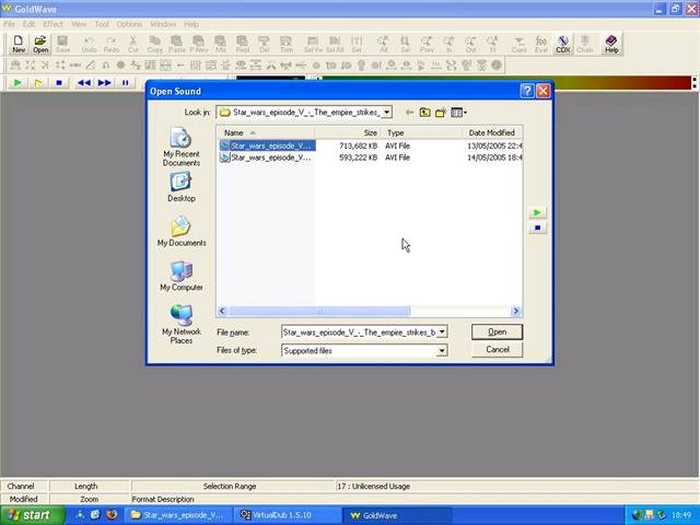

    1. Open up GoldWave.
    2. Click File>Open and pick the video file:

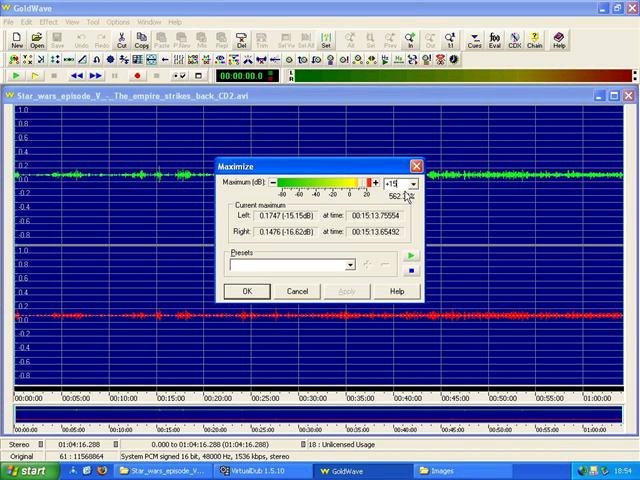

    3. After it has loaded, click effect>volume>maximise:
    4. Not in the box on the top right of the window that comes up, choose a suitable value.
    I normally choose +15dB, but put it up and listen to the preview.
    5. After this has done, click file>save as... And save the output Wav file

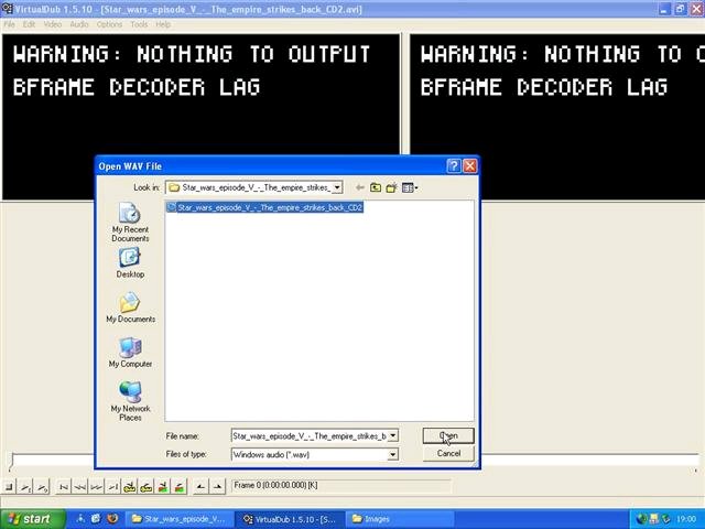

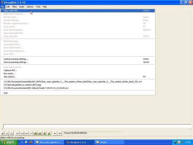

    6. Close goldwave, and open VirtualDub. Click File>Open video File:
    7. Click Audio>Wav Audio. And pick the file you saved from Goldwave.

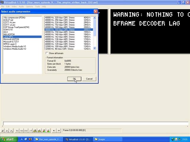

    8. Click Audio>Full processing mode. Then Audio>Compression. And in the box that comes up Click Lame MP3 on the left and The bitrate you want on the right:

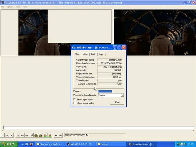

    12. Wait for it to finish encoding and then you are done:

    I think I followed the instructions well, but step 8 does not display LAME MP3 as a choice. I rebooted, no change. Can anyone help me with the correct install for LAME?
  12. You need to install LAME ACM, not the DirectShow version.
    http://www.rarewares.org/mp3-lame-dshow-acm.php
    Nov 2008
    That was it. Thanks

    I'm stuck at step 7...VirtualDub wont open the Wav files I've saved.
    Help please
    Feb 2009
    Australia
    Nevermind...Thought it meant to open the Wav file when you click "Open VIdeo File..." thought that was a bit odd. Other than that, cheers
