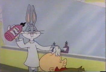

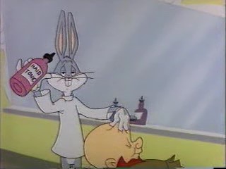

    I use the MSU Deblocking filter, followed by a strong Temporal Smoother, and a little Sharpening. Here is a sample frame from an old VCD file (recorded off air?) converted to XVID AVI:
    VCD:
    XVID:
    Obviously, it's the filtering that's improved the picture quality, not the re-encode per se. And in this case the source was very noisy so it was easy to improve.

    You think that second picture is "improved"?
  7. Originally Posted by Gurm
    Yes. The macroblocks and broadcast static are gone. There is roughly the same amount of codec ringing, and the images are similar in clarity. Since the output was AVI I also changed the pixel aspect ratio to 1:1.
  8. Banned
    Join Date: May 2003
    Location: Massachusetts
    If you say so. Stretch it out and I bet they look pretty much the same. LOL.
