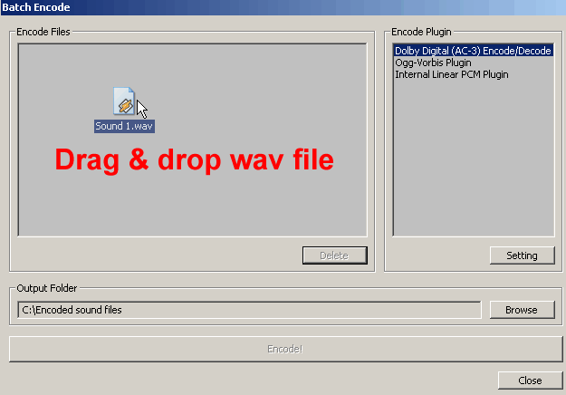

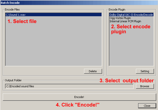

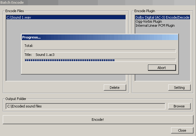

  1. Converting WAV file to AC3 file(Dolby* Digital) & AC3 file to WAV file
    using TMPGEnc Sound Plugin AC-3,
    produced 100% DVD compliant AC3 files.

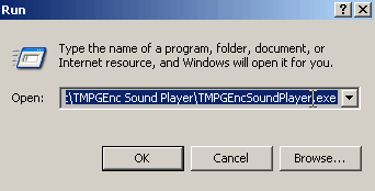

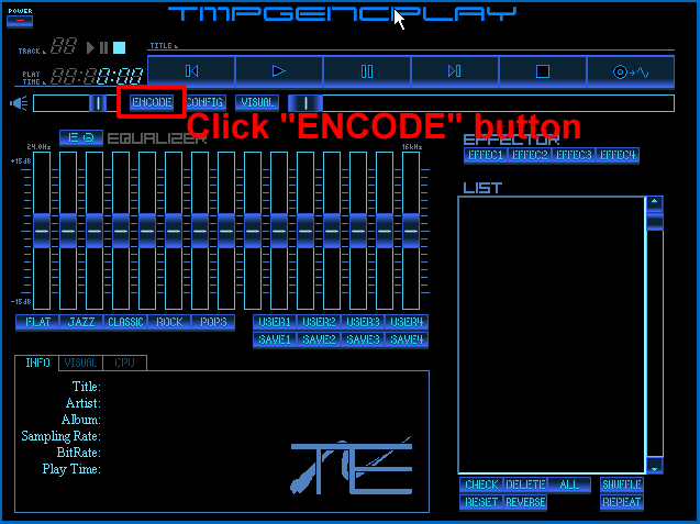

    On Windows click START => RUN
    Copy and paste to RUN window this text in blue color:
    C:\Program Files\Pegasys Inc\TMPGEnc Sound Player\TMPGEncSoundPlayer.exe

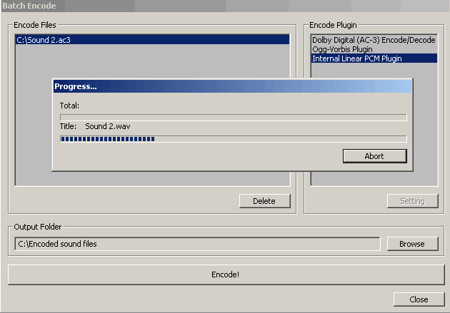

    On converting AC3 file to WAV file just select PCM plugin
  2. I don't understand it. When I try to drag and drop the file nothing happens. No file or nothing. Anyone got any ideas?
  3. UPDATE: Some user have problem, the program do not accept the WAV file.
    Opening WAV file with GoldWave and save as WAV file in difrent name, solve the problem.
