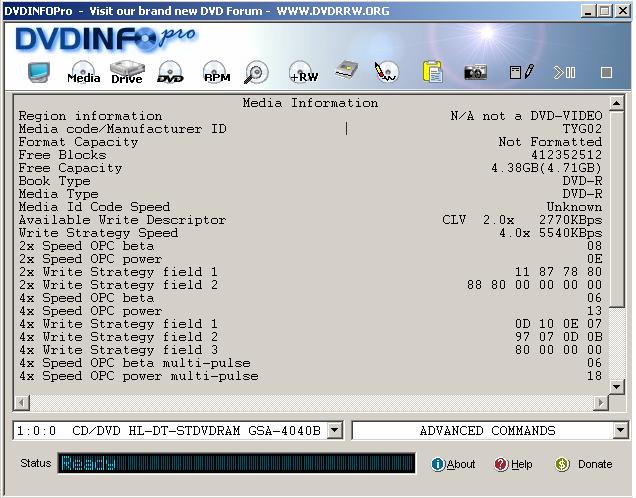

  1. I orderd a 100 pack of Taiyo Yuden Printables from SVP Communications (www.blankdiscshop.co.uk). Recived them today and run a verification in DVDINFOPro and it tells me that these discs are 4x .
    I tried to burn one disc and expect it to burn at 4x, but no no it only burns at 2x!!! I have a LG 4040b for the moment, but it should burn them at 4x anyway.....
    I paid a half fortune for these discs, almost 1€ each and realy except to get what I paid for, but it's seems like they tried to trick me?
    Here is a scan from DVDINFOPro:
  2. TYG02 is the media code for 8x DVD-R from Taiyo Yuden so it looks like you got what you paid for.
    So it looks like a problem with your burner IMHO. Did you update the firmware to the latest one?
    -Shmorq
  3. Ohh then it makes sens. However it's strange it find datasafe as 8x and Taiyo Yuden as 4x? Haven't updated my burner for some time will check if they have released a new firmware right now,,,,

    Found a new firmware and updated my burner. They now burn at 4x However DVDINFOPro still find them to be 4x??? Are you sure the TYG02 media code gurantee they are 8x?
    Join Date: May 2004
    Location: United States
    You have a 4040B, so I'd be surprised if it even recognized a disc had an 8x write descripter since it's a 4x-only burner.

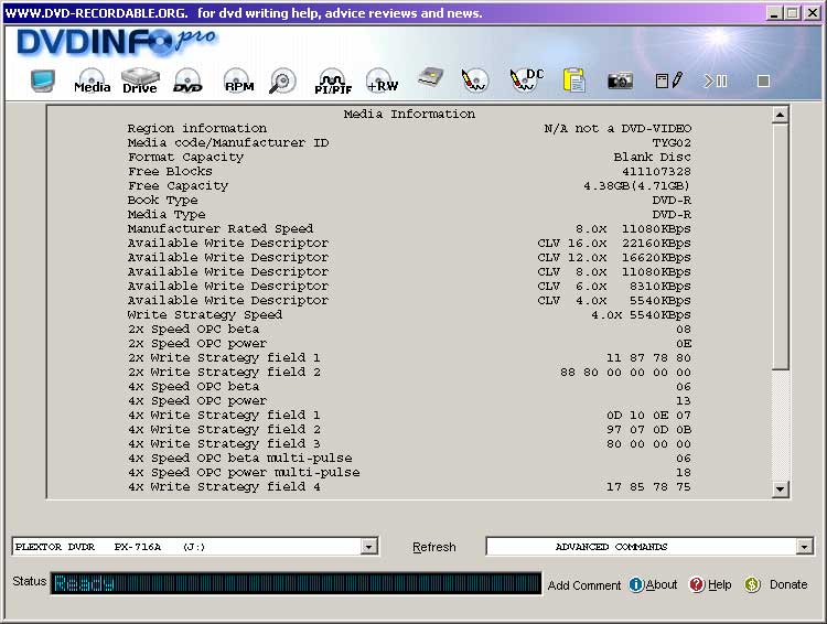

    This is what mine looks like:

  9. I just thought it was strange it did recognize the Datasafe dvd+r as 8x, however I guees I don't have to worry anymore.
    Join Date: Aug 2002
    Location: Pittsburgh, PA, USA
    It would only recognize it as higher if your burner supported it higher. Since your burner only supports speed as high as 4x,that is the highest write option you will see from any media,even 16x media,in your burner.

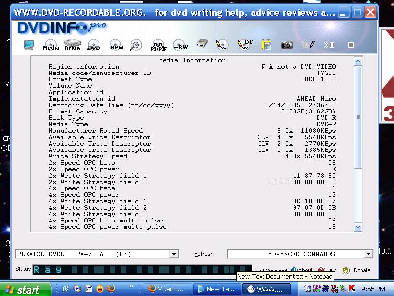

  11. a few months ago, i ordered 8x taiyo's from rima.com. no matter what i did, my plextor 708a would not burn at 8x. dvdinfo gave me the same readings as this post writer has shown. rima was very good about it, even credited 10 bucks back to my cc. i'm sure it was not their fault, as they do not manufacture the discs. they still kinda insisted they were 8x. i ordered same dvd/r's from same store and had same problem. not so much a problem, but i smell something fishy. not with rima or other retailers, but with taiyo possibly. i was kind of expecting to get the 4x the second time around, not making that big of a deal of it because they are great discs and rima is reputable. i've tried different firmwares to no avail. even nero say's it can't burn em at 8x. this is even after a clean install of xp and nero along with other burning apps that refuse anything other than 4x. odd.
    Join Date: May 2004
    PX-708A can burn DVD+R at 8x but DVD-R is limited to 4x.

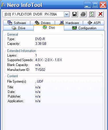

  13. and from nero...

    DVDINFOPRO says 8x under Manufacturer Rated Speed. but only 4x under Available Write Descriptor because YOUR BURNER does not support a faster speed. When Rima insisted the media is 8x they were correct. another case of user error...
