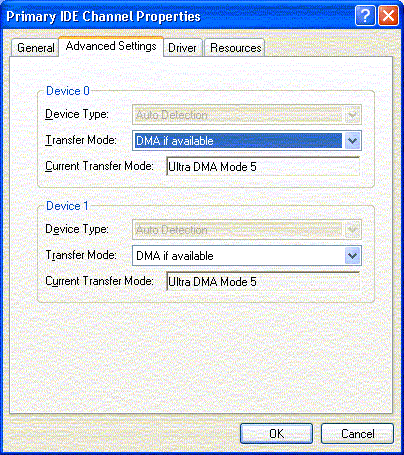

  17. Member mikesbytes's Avatar
    Join Date: Jun 2003
    Location: Sydney, Australia
    I have a generic computer, so those bodgy cost cutting things that seem common on some brand computers doesn't apply.
    Looks like I have ultra DMA 5
    Have a nice Day

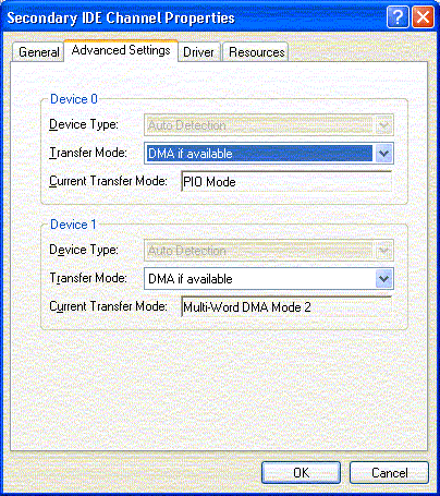

    That's only the primary channel though. Most standard build computers put hard drives on the primary channel and use an 80 way cable and optical drives on the secondary channel and use a 40 way. Using a 40 way cable will usually show up because the transfer mode will be Ultra DMA Mode 2.
  19. Member mikesbytes's Avatar
    Join Date: Jun 2003
    Secondary Channel
    I was also trying to tell where my CD Burner was pluged in, the driver says Location 0 (0)
    Have a nice Day
  20. Member Skith's Avatar
    Join Date: Oct 2004
    Location: Bottom of the ocean
    If your writers are on the secondary IDE channel, having them in PIO and Multi-Word DMA is not a good thing. You want (your DVD Writers especially) in at least Ultra DMA Mode 2. Some writers show up with higher UDMA modes, but the 33MB/sec transfer of UDMA 2 is more than sufficient, even for 16x burns (~22MB/sec).
    I believe Multi-Word DMA 2 is ~16.6MB/sec. That is only fast enough for 8x DVD recording.
    PIO is plain bad... slow and hogs resources. Try switching (forcing) the devices into UDMA 2. Also try removing the old CD-Writer and have the Pioneer drive installed as Master (you may have to change the jumper).

    The PIO is probably the old cdrom drive that doesn't work. The DVD burner will be replacing it anyway.
    Looking at Skith's pictures, I probably have a 40 wire lead. Can I simply plug an 80 wire lead in, or do I need to get a new controller card? I have DMA100 on the motherboard.
